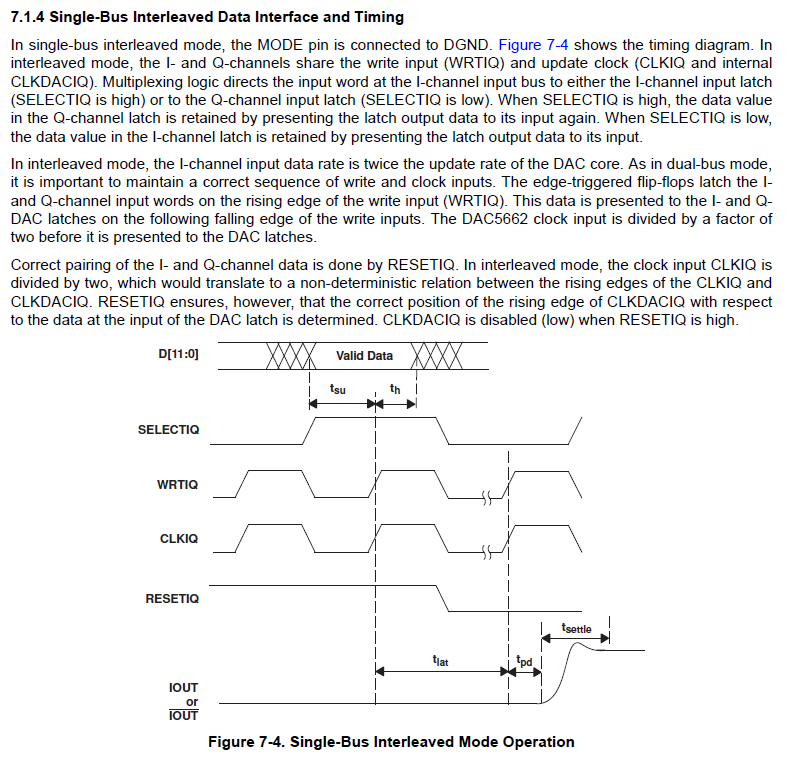

Part Number: DAC5662
When using the DAC5662 in interleave mode, it is only briefly mentioned on how to use RESETIQ.
Are there more example timing diagrams somewhere that are more detailed than Figure 7-4 in the datasheet?

Hi JDJ,
The RESETIQ is used to initialize the internal CLKIQ divider to the correct phase and CLKIQ and WRTIQ can be connected together.
As shown in the section taken from datasheet. WRTIQ and CLKIQ can be connected to together. SELECTIQ are is high when data for output channel A is sent and low when data for output channel b is sent to the DAC. RESETIQ is high to initialize the phase of internal CLKDACIQ and can be kept low afterwards,
Please make sure the setup and hold timing as shown in diagram above between WRTIQ, CLKIQ, SELECTIQ and RESETIQ is maintained.
