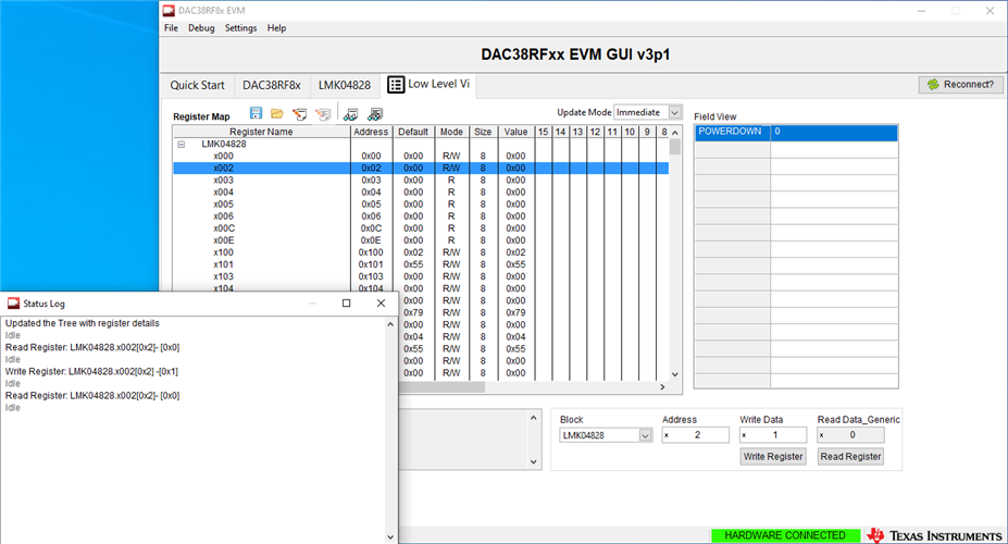

We can't get the DAC38RFxx EVM GUI v3p1 interface to work with the DAC38RF82EVM evaluation board.
All our tests were performed on a Windows 10 EN machine (United States).

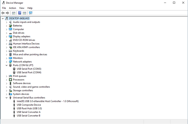

The evaluation board is well recognized by the computer (Device manager).

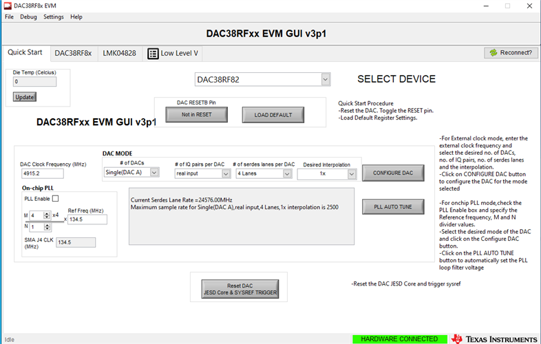

The DAC38RFxx EVM GUI software detects the evaluation board and does not display any error messages at startup.
By navigating on the " Low Level " tab, it is impossible to modify the value of the registers. Indeed, when writing the value 0x01 in register 0x02 of the LMK04828, this value is not taken into account by the LMK and then return 0x00. It does the same with all registers.
The command to write to the registers of the LMK04828 and DAC38RF82 via the GUI interface do not work.
We also tested the board with different versions of FTDI drivers (v2.10.00 and v2.12.28), without success.
Could you please tell us how to make the DAC38RFxx EVM GUI v3p1 software work on our windows machines?
