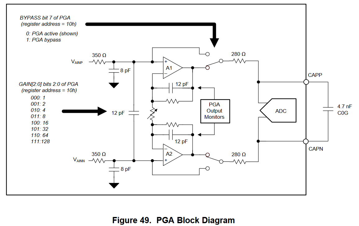

    I am seeing different offset, gain register values when run in PGA bypass and PGA mode (gain =1). Ideally both these configurations should give same offset, gain values right?
    Also, when calibration is ran in PGA mode (gain=1), I am seeing PGAL_ALM bit is getting set. I am not sure why it is getting set. Since, I am using AIN0 and AIN1 as reference. (VDD is +5V and VSS is connected to Ground, for your reference). Please suggest your inputs.
    As per table 7.3, Differential input voltage range is +/-Vref/Gain. Does this mean, we always need to measure differential inputs in PGA mode? Please suggest.
    Ram.
  • Hi Ram
    As you can see from the block diagram below from the ADS1261 datasheet, the PGA enabled vs bypass paths are different. With the PGA enabled, the input signal must pass through the amplifier stage, so I would expect the offset/gain to be different with PGA enabled vs bypassed.
    For the PGA_ALM bit: note the requirements in Equation 5 in the ADS1261 datasheet (pg. 31). With the PGA enabled and G = 1, the absolute voltage on each input must be between AVSS+0.3V and AVDD-0.3V. This is to keep the input signals within the common mode range of the PGA, and avoid the PGA's nonlinear region of operation. As a result, a 0V and 5V input voltage violate both of these requirements, setting the PGA_ALM flag high. If you intend to have this voltage range, you might consider disabling the PGA.
    Finally, the ADC always takes a differential measurement between the voltage applied to AINP and the voltage applied to AINN. You may have applied 0V to AINN and 5V to AINP, which is technically a single-ended measurement, but the ADC always treats the measurement as differential (VIN = AINP - AINN)
