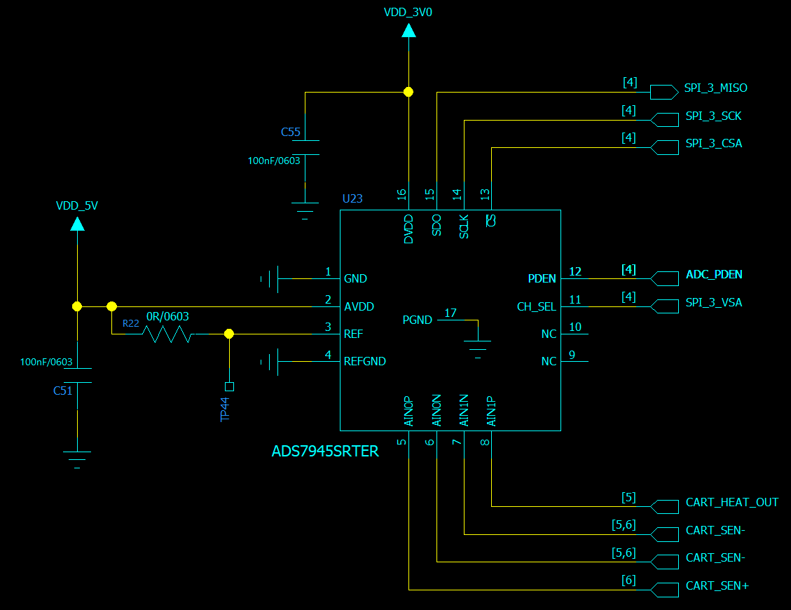

Hello TI experts,
my customer considers ADS7945 for their product, they drew first schematic.
please review the schematic below;
they want to use 0V~5V PWM signal as input, and 3.0V for output digital signal.
so please check the voltage of AVDD, REF, DVDD are right.
and i have one more question, about power down mode in page 30 of datasheet.
in datasheet, "Note that the device looks at the PDEN status only at the CS rising edge"
then what is the first sequence? PDEN to 1 and make rising edge for \CS next? or first make rising edge for \CS and PDEN to 1 next??
how about from power down to normal operation? should we follow PDEN to 0 and \CS falling edge?
please give me a detailed description about this. Thank you.

  • Hello Chase,
    The basic connections you've shown to the ADS7945 are correct, but there's admittedly not much shown around the device in terms of what's connected to the inputs.  Here are some notes based on the schematic and your comments.
    1.)  We recommend a separate reference decoupling capacitor (100nf - 1uF) connected directly between the REF and REFGND pins.  Currently this capacitor is shared with AVDD.  Extra inductance in the reference capacitor connections will reduce performance due to ringing on the internal reference circuitry when the inputs are converted.
    2.)  Supply voltages for AVDD, REF, and DVDD are fine for a +5V analog system with +3V digital I/O levels.
    3.)  If running at full speeds it's likely that the performance would improve with an input buffering circuit that will help charge/discharge the internal sampling capacitor during the acquisition period.  For more details on the theory behind this take a look a these videos.  We recommend you reference the information in the videos over the datasheet applications section as the videos have the most refined versions of the design process versus what was available when this product released.
    https://training.ti.com/node/1139106?context=1139747-1140267-1128375-1139106
    4.)  In regards to the PDEN pin, basically there's an latching circuit that sets the state for the internal power-down state which is triggered on the rising edge of /CS.  No internal changes occur to the Power-Down state until the PDEN state change is latched into the internal state machine by the rising edge of /CS.
    So, yes, you'll need to change the PDEN pin logic state, before the /CS signal rises to toggle between power-down and active modes.  There are some examples in Figures 83-85.

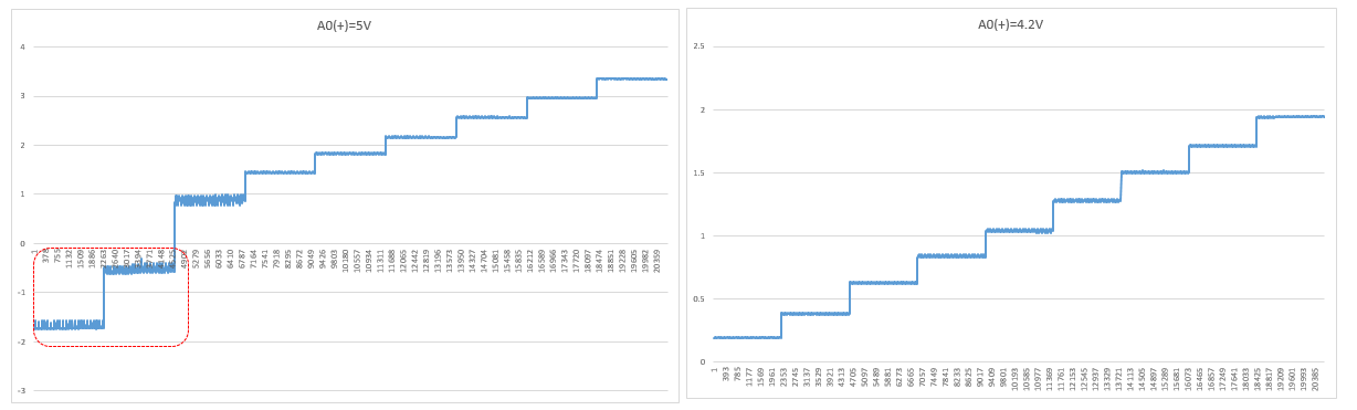

    Now they test their concept with ADS7945EVM-PDK, and there is some problem.
    1. the schematic is as below, we replaced MCP3301B_B to ADS7945EVM-PDK.
    2. they used 5V for AVDD and Vref.and DVDD is 3.0V for SPI communication in ADS7945EVM.
    3. The PWM signal, Drain pin of Q7 is changed to 10% to 90%. high voltage is 5V.
    4. If we put 5V in A0(+), minus value is created in A0(+)/A0(-) differential voltage mode. (see left of the picture below)
        if we put 4.2V in A0(+), minus voltage is not created in A0(+)/A0(-) differential voltage mode. (see right of the picture below)
    5. What is the reason that we get minus value if we use 5V in A0(+)?
    we tested the steps of 0.1V, and the value over 4.2V (4.3V to 5.0V) created minus value.
    and we should use 5.0V for A0(+), cause the PCB is very small. we cannot use even one small LDO.
    please check this issue, and let me know if you have more information for this matter. Thanks.

  • Hi Chase,
    I see the challenge now that you've provided a more zoomed out view of the application.  With a +5V supply and a high-side current sensing application, the input common-mode voltage to the ADC will be roughly +5V.
    The ADS7945 has an input common-mode voltage range of VREF/2 +/-200mV.  This is copied from the datasheet below.  You would need to use a device with True differential inputs to accommodate this type of application.
