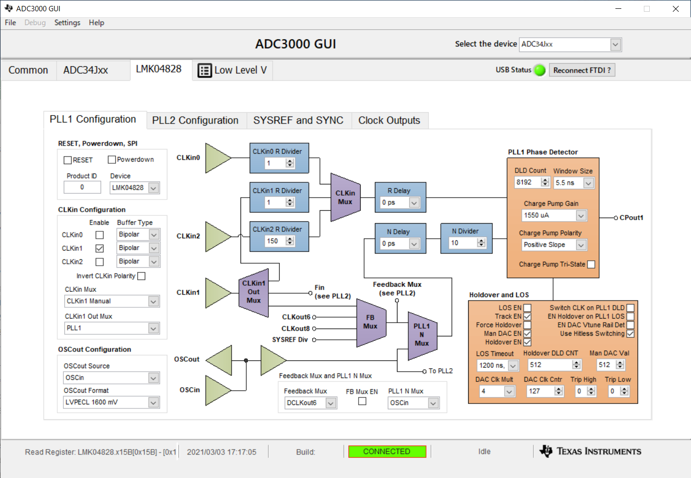

We have a problem that PLL1 of LMK04828 mounted on ADC34J45EVM does not lock by external clock (CLK1IN).
The external clock is a 10MHz sine wave.
LED D3(LMK LOCKED)  is not turning on.
But, LED D4(PLL2 LOCKED) is turning on.

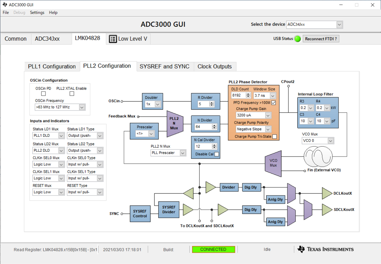

I've attached our ADC3000 GUI settings so can you tell me if there's anything wrong?
Regards.

    Make sure there is a shunt on JP6 and you see 100MHz at C92. On the GUI, in the PLL1 Configuration tab, disable "Use Hitless Switching" which is located in the burnt orange box. I notice with this enabled, sometimes it prevents PLL1 from locking. What is the amplitude of the 10MHz input on J10?
    Jim
  • Hi jim,
    Thank you for your comment.JP6 is shunted. I saw 100MHz on C92.
    I disabled "Use Hitless Switching" but did not lock PLL1.
    The amplitude of the 10MHz input on J10 is 2Vpp. I set The amplitude of the 10MHz input on J10 to 3Vpp or 4Vpp, but the PLL1 did not lock.
    Can you tell me if the frequency or amplitude is wrong?
    Regards.
    Please load the configuration file "ADC3xJxx_128MSPS_Operation_LMK_Setting", and then make the edits that you shared to the PLLs. I removed the jumper from JP6, and supplied a 100 MHz sinewave (+10 dBm) to J10. I also tried with a 10 MHz sinewave input, and it worked as well.

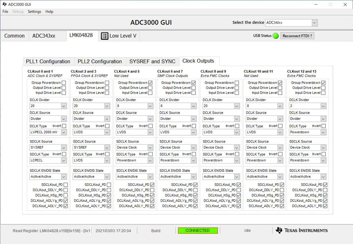

    While I did not get the PLL1 LED to turn on (lock), I did get valid data capture on the TSW14J56EVM. Additionally, please ensure that the LMK clock divider "CLKout 2 and CLK3" are set to "10", not "20".

    I would like to suggest increasing the window size from 5.5ns to 18.6ns or 40ns to see if this lets PLL1 lock
  • Hi Chase,
    Thank you for your comment. I tried changing the window size and LED D3 turned on a little. In this state, I set "Status LD1 MUX" to "PLL1_N/2" and "Status LD2 MUX" to "PLL1_R/2". When I saw "PLL1_N/2" and "PLL1_R/2" on an oscilloscope, they were asynchronous. Does this result indicate that PLL1 is unlocked?
    I believe the reason it's not as bright as the other status LEDs is it's not constantly on due to locking and resetting. If you decrease the required lock count register, PLL1_DLD_CNT at address 0x15C, does the LED come on brighter (since it will lock more frequently)?
    Thanks, Chase
    I decrease the lock count register(PLL1_DLD_CNT), and the LED became brighter. But again I saw "PLL1_N/2" and "PLL1_R/2" on the oscilloscope, they were asynchronous. Is this a problem?
    Can you tell me the proper PLL1_DLD_CNT and PLL1_WND_SIZE settings?
  • Hi all,
    The slew rate of a 10MHz sine wave clock is bad, this could be one of the reasons why PLL1 did not lock. Increasing the voltage swing can improve slew rate but 4V seems to be violating the electrical spec. If possible, use 10MHz square wave clock. To debug, we can use 100MHz sine wave clock, but set CLKin1 divider to 10 to maintain the same fpd.
    PLL1 fpd is 10MHz, so I think the lock detect window size may not help too much. To debug, I agree to make window size bigger and DLD count smaller.
    PLL1 fpd is 10MHz while the charge pump current is 1.55mA, what is the intended loop bandwidth? What are the loop filter component values?
