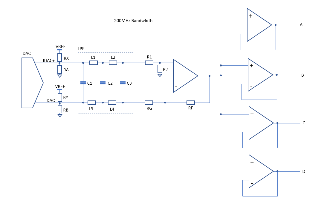

I am looking for a suitable solution to be able to connect the DAC37J82 to four identical loads.
Below is a discrete solution.
Regards Joe

Thank you for the reply.
Sorry, I did not paint the entire picture. I need 1:8 and cannot used two quad DACs so the plan is to use one dual channel DAC and two 1:4 fanout circuits per channel. The question relates to the best way to achieve 1:4 when connect to one channel of the DAC. One manufacturer offers a 1:4 video distribution amplifier. I am wondering if TI has something similar for 200MHz bandwidth or recommends discrete single and quad op amp solution.

I would suggest contacting the high speed amplifier group. They should be able to suggest parts and provide a solution I would think. I have also attached a couple of documents that explain how to properly terminate a DAC when using an amplifier.
Jim
