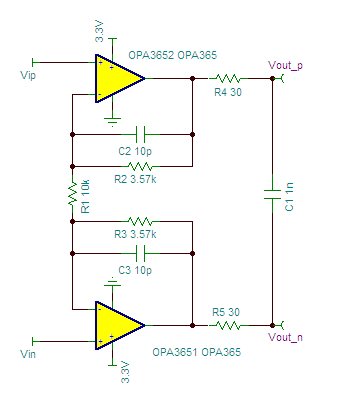

I would like to use ADS8363 fully differential driver configuration as reported in ADS8363 data sheet page 39 with following values:
C 1nF as suggest on data sheet
R = 4 Ohm as calculated using (6), n=16, tacq =100 ns
R1 between OPA2365 output and  non inverting input 3570 Ohm
R2 between the two OPA2365 non inverting input 10 KOhm to have a 1.7 amplification value.

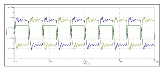

Simulating with spice (OPA365 model from TI) and applying a differential 2 MHz square signal duty cycle 50 % (rise and fall 10 ns),
circuit output present an oscillation that could corrupt ADC read value.
Is this behaviour real ?
Do I need a stabilization trick like a feed back capacitor (10/20 pF) ?
Thank you in advance,
Daniele.

  • Hi Daniele,

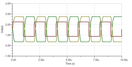

    I simulated your circuit in TINA-TI and I was able to replicate your results (see below). I think you can expect to see these results on the bench.
    There are some modifications you can make to the circuit to improve the settling time and overshoot. In my simulation I incresed the value of the isolation resistors (R4 and R5 below) to 30 Ohms and I added a feedback cap of 10 pF, as you correctly suspected. This resulted in the following waveforms:
    One thing that is worth noting is that there is a driver delay between an input change to output settling of about 400ns (shown in the following graph). If this delay is too long for your application then a faster driver with more bandwidth should be used.
