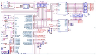

Hello - I have the same problem with the chip by ESD like the thread "TLV5632IDW sensitivity" Only by ESD pulse about +/ 7kv all the analog output will be going to 0V. And it is not possible to update the DAC output. If the Error occurs, I have checked the signals from the uC / SPI. The SPI Command (SCLK, FS, DIN) include the timing are ok. Also the expected Data are correct. The GPIO Bits (LDAC, PRE) also ok. We have tried a software reset to exclude an error in the software. After the SW Reset the error was still present. Only if I shut down the VCC Power the chip will reworking correct. It seams that the chip have an internal hang up so they will no more understand any software orders. What is the problem and what can i do that the chip will working correct again?
schematics

    I am not sure what exactly is causing the TLV5632 to lock up, but it is possible there is some kind of brownout event in the device from AVCC momentarily collapsing.  I recommend you approach from two different paths:
    1. See you can attenuate the stress on the device by implementing additional power supply filtering (ferrite beads, high fC RC filtersin, additional supply decoupling) and additional power supply protection in the form of TVS and ESD diodes.
    2. You can try disconnecting DVDD from the VCC supply and drive it directly with a GPO pin from your MCU.  THis pin only needs a few mA to operate, so it is possible you could use the GPO as a combination DVDD/RESET pin.  That might allow the device to recover.
    I am not aware of any internal register that can be used to reset the device internally.
  • Another hello. So, now we are a bit further. We have tried to change the signal from high to low and back to high via software at the PRE pin when the error is present. With this, the DAC accepts the data correctly again when the analog values are reloaded.  All other pins bring no success. There seems to be an internal malfunction with the preload register, so that the default value is always emitted and the SPI interface therefore does not react anymore.
    Now an extended question: Is it possible to outsmart the internal logic with this software trick, so that the device works correctly again without a physical reset signal? A change of the hardware is unfortunately no longer possible with this product.
  • Hi Herbert,
    It is difficult to say for sure if there is a way to recover from this condition, as I am not sure what exactly is halting the internal logic.  It is interesting that the PRE pin recovers this behavior.  I would be would an interesting experiment to try to implement additional protection on that pin to see if it is root of the failure.  I think if you cannot implement any other hardware changes, then you should leverage this PRE toggle for recover.  I suspect that the PRE pin will clear the input register at a hardware level and likely causes a partial logic reset.
