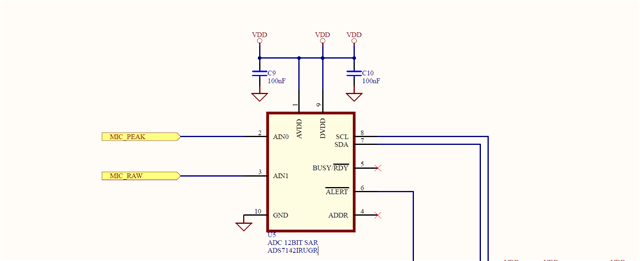

I am using this chip to read both channels. Manual mode.
I can probe the legs and verify the values of both channels are above 1.5v.
But when I read the data registers, both registers are zero.
All the i2c register writes and readings are given below.
I can provide you the complete schematic privately if you like.
Can you please review and let me know whey the ADC readings are zero here?

  • Hi ATL_ENG,
    During your initialization sequence of the ADS7142, you write various values to different registers, but you always seem to read back 0x10.  You have a few error statements in there as well that seem to confirm this (mixing DEC and HEX here makes it more difficult to read).  Do you have scope captures of your I2C communication?
