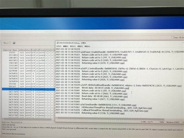

  • Hi Paul,
    This is GUI's log txt file I found which is recording all the manual configurations. Is this the macro you were talking about? The "wrote data" line recorded exactly what I did for each action. If this is the script you were talking about, how can I recall it?
    Siyuan
  • Hi Siyuan,
    I was mistaken about the Python Scripting functionality.  Most of our labVIEW GUIs have a python scripting tool, but apparently this GUI does not have it.  This means that it would be pretty difficult to get outside control of the GUI.  Even with the scripting tool, it would not be totally transparent to your software.
    I would recommend that you use some kind of generic SPI controller to automate this.
    Paul
  • Hi Paul,
    Thanks for your recommendations! Maybe we'll try NI's SPI interface device to program this evaluation module.
