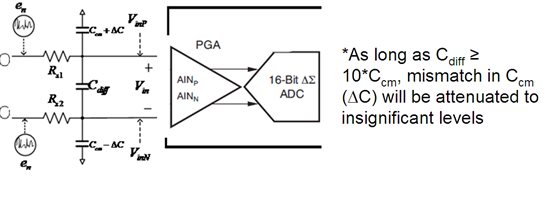

    Sorry, I was not in the office yesterday so couldn't reply u.I have some doubts. U mention about flexibility after adding low-pass filter, I didn't get the idea of flexibility?
    If not using the low-pass filter, we can populate with 0 ohms resistors, what I get the idea is to add these resistance in series with the line resistance. Is this right?
    Can u give me some examples wherein such low pass filter has to be used? I have certain measurement which is to be done using RTD, so I can make such changes even to that circuit.
    What is the value of ΔC?

  • Hi Himanshu,
    Reading through the application note SBAA180, the application note provides optimal examples on how to configure and connect  the RTD's with the ADS1248.  It is recommended that when the IDAC current is used to excite the RTD; that this IDAC current is also used to produce a voltage accross RBIAS to generate the voltage reference used for the conversion.  This creates a ratiometric measurement where the drift and noise of the excitation is seen both at the reference path and the signal path.  Since this noise and drift is seen by both the signal path and the reference path they tend to cancel.  Applying a heavy filter to the RTD signal path could create a mismatch of the noise/drift that is seen at the RTD signal path and the reference path; and the user will not have an effective ratiometric measurement . However, depending on the users particular situation, and the specific nature of the noise in the users environment, in some cases may be beneficial to add a light low-pass filter on the RTD channel. For example, some customers choose to use a EMI or RF filter at the RTD channel; the corner frequency of the filter for EMI/RF filter is much higher than the noise components of the excitation current.  The decision to use a low-pass filter will depend on the noise environment on the engineers particular application and the engineer's decision should be based on their noise environment and their experimental results.
    The application note refers to the parasitic line resistances of the connections between the remote RTD and the ADS1248.  The two wire is the simplest  method to connect the RTD; but the line resistances may cause errors when the RTD is placed far from the ADS1248 device. The three-wire  configuration greatly reduces the errors due to the parasitic line impedances.  If you choose to use the three-wire configuration with hardware compensation, you could choose to add a compensation resistor in the second arm of the RTD.  The RCOMP is a precision, very low temperature coefficient resistor chosen so that is equal to the RTD resistance in the middle of temperature range.  This provides the advantage of providing a measurement that is centered around 0V differential and may allow to use more gain on the PGA. The four-wire configuration provides the highest level of accuracy since it isolates the excitation path of the RTD to the sensing path.  Please refer to the SBAA180 application note link below.
    The ΔC in the discussion of the RC differential filter below is dependent on the mistmatch of the capacitors (Ccm) used on the filters on the two channels where the differential measurement is taking place.   To minimize the effects of the capacitor's  mistmatch, it is recommended to use a filter with a capacitor across the inputs (Cdiff) that is 10 times larger than the Ccm capacitors chosen.  The values of the Cdiff, Ccm depend on the corner frequency that is desired.  Please find the power point slide  "lowpassdiff.ppt" atttached for a generic differential filter below.
    Luis

  • Hi Luis,
    That really helped me alot and cleared many doubts of mine. Thank you so much.
