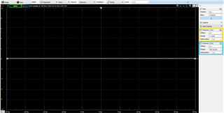

We've hooked a scope up to the INTB pin and triggered reading of DATA0_MSB and then DATA0_LSB  and INTB didn't change state.    We've also tried reading the Status register 0x18 to see if that would cause INTB to de-assert it didn't.  The value in 0x18 is 0x48   which according to the data sheet is the Data Ready Flag and the Channel0 Unread Conversion, which seems correct.

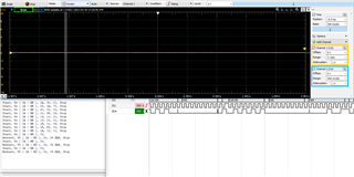

  • Hi Nicole,
    CH1 on the scope is connected to INTB
    Bottom left is a snoop that is connected to the I2C bus so we can see what is being transmitted and the bottom left is a feed from a logic analyzer that monitors the snoop connection so we can break down and I2C communication if required to verify we composed the message correctly.
    The read command executes correctly and if we present a target to the coil the values received change so the LDC appears to be working correctly.  We just seem to be unable to drive the microprocessors data acquisition utilizing a ISR driven by the INTB pin asserting.
