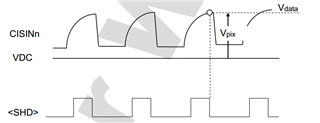

CIS output is DC signal and the output range is about 800mV.
Now we use SH2b working mode. We refer to the 0638.LM98620_register_example_Dec2020.pdf that reg 01 with value 48,  reg 23 with value 00.

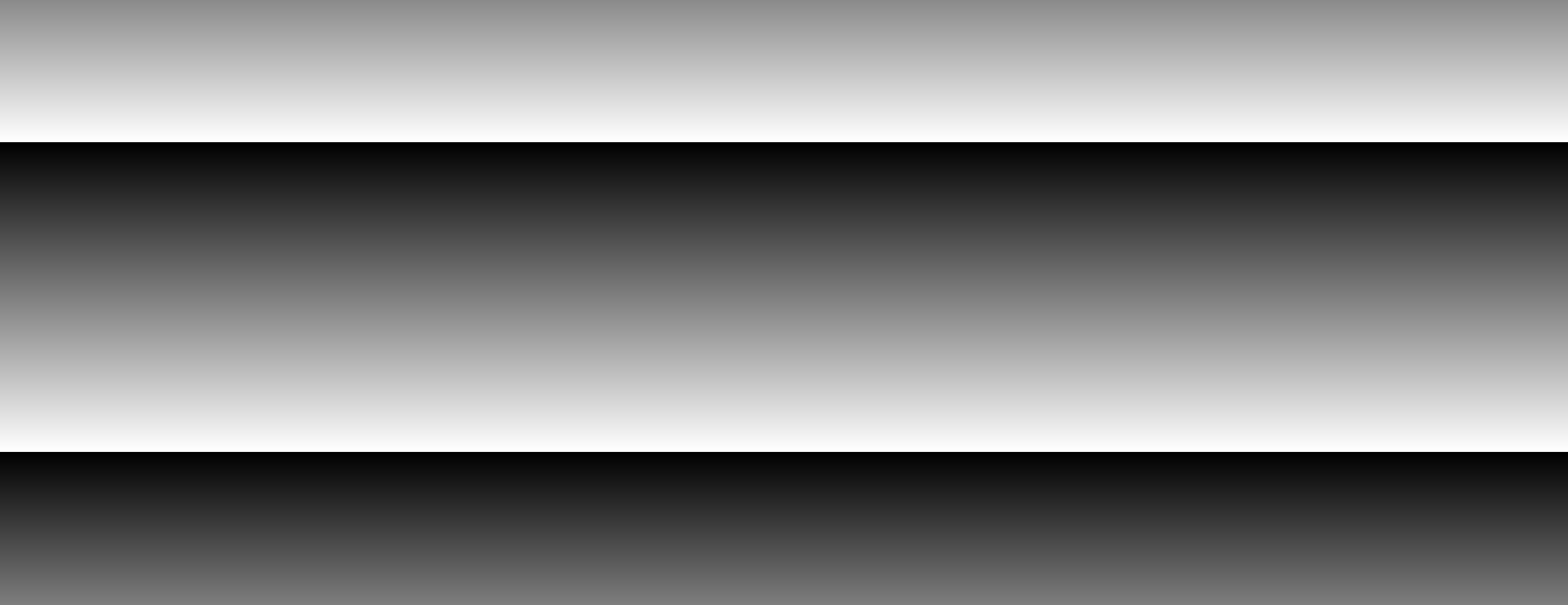

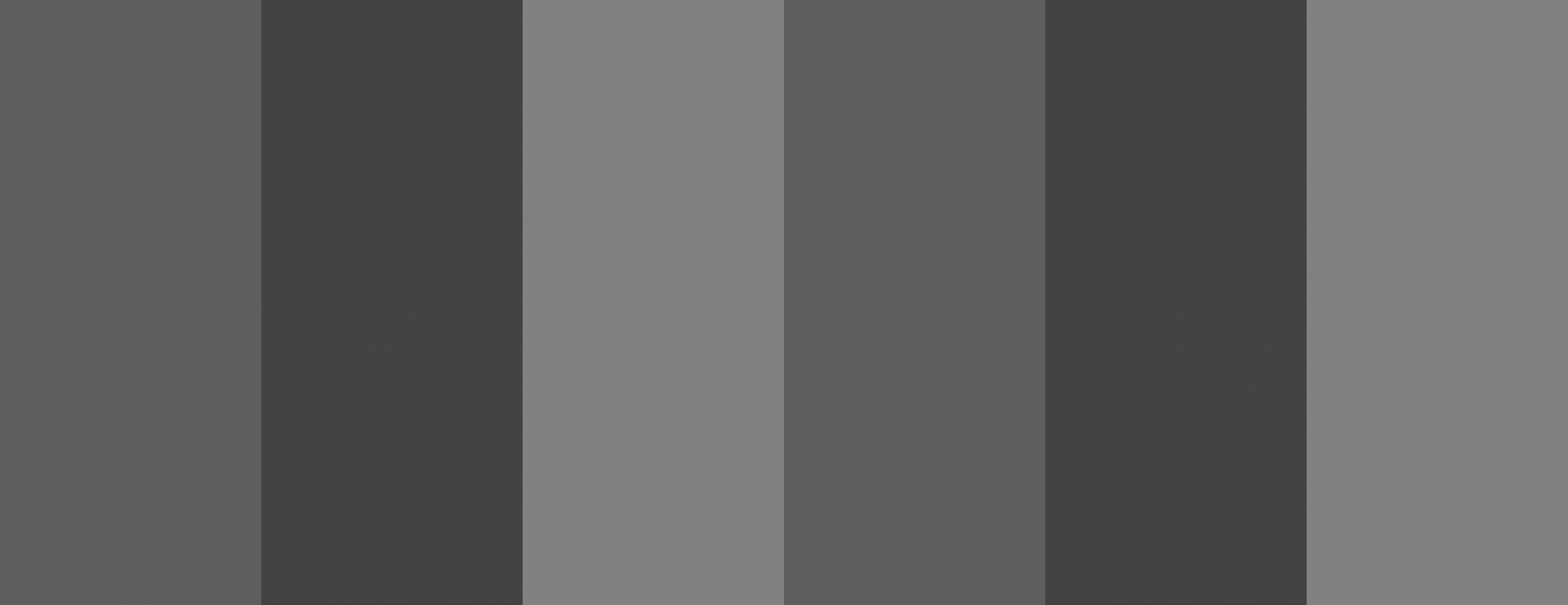

Issue: using test pattern mode,  output OK.

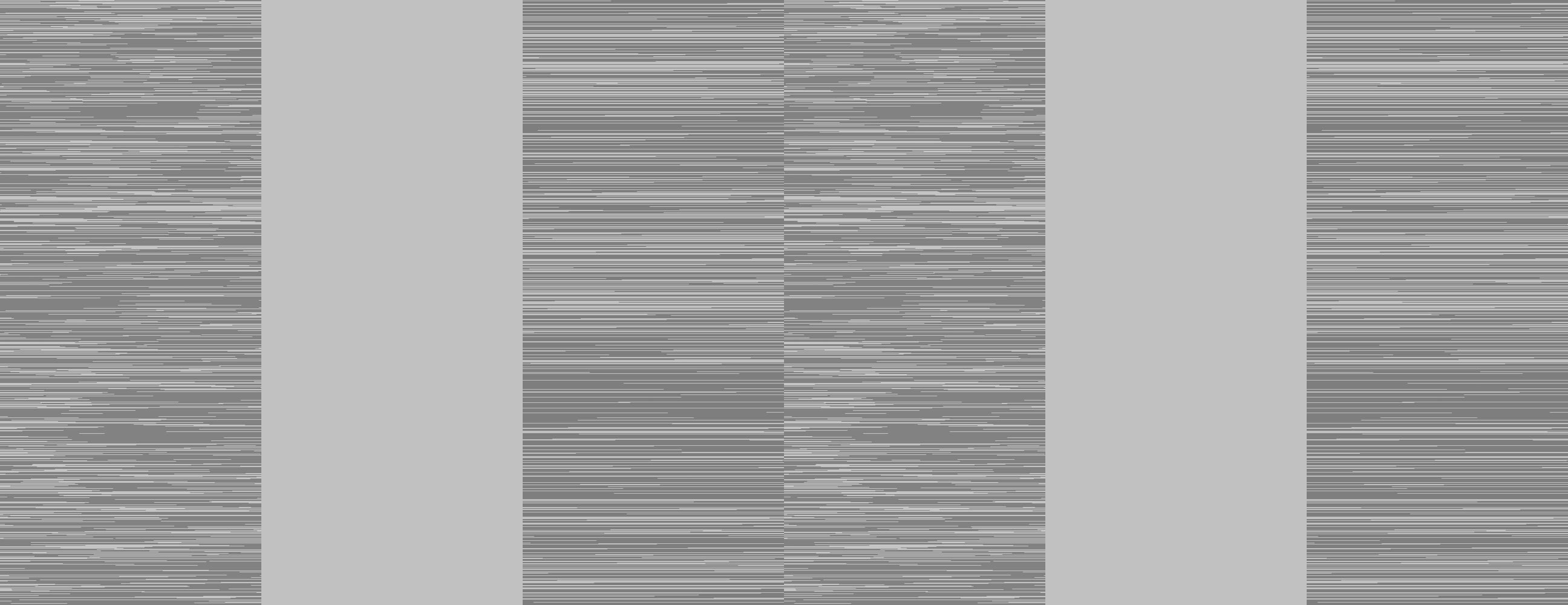

When changing to normal mode, the output data are all 0. And the the data will increase with the time. Try to input a certain voltage to analog input. the output is not related to the input.
