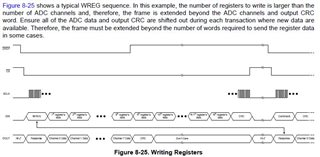

    On the ADS131M08, you will use the same command for both single and multiple register reads. The op-code is a fixed two-byte op-code, which contains the starting address and the number of registers to read minus one. If you are reading only one register (nnn nnnn = 0h), then the register contents are contained in the response word of the next frame, followed by channel conversion data (Figure 8-23). For multiple registers, the response contains an acknowledgement of the command, followed by the register contents of each register requested in place of the channel data. The frame must be extended to accommodate all of the register data (Figure 8-24).
    To write multiple registers on the ADS131M08, you simply need to extend the frame to accommodate the total number of registers written.
