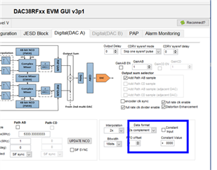

    4. There should be constant tone pattern by enabling the constant input, set constant value to be 0x3FFF for instance (with default 2's complement format). You should observe a tone at the NCO output. Please try this and report back. This should verify the DAC itself is configured correctly.
    [Imran] : we will try this step and let you know the observations. We are using Oscilloscope to observe output on DAC output SMA. Does this NCO output is DAC output SMA or something else?.

    we have tried enabling constant input and have set constant value to 0x3FFF, but we are not seeing any output across DAC output pin.
    we have monitor the SYNC~ signal in FPGA and observed that correct CGS and ILAS code transitions. after monitoring internal signal, it seems that JESD204B TX + XCVR is working correctly. Please see the attached PPT for monitored internal signal waveform with SYNC~ triggered. please let us know if anything else need to be done.
    Imran
