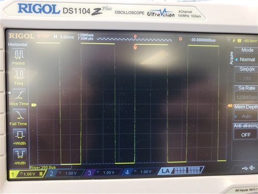

  • The SPI mode should be correct. It's configured as CPOL =0 and CPHA = 1 which should correspond to SPI mode 1 in the datasheet.
    This is the readout we get from DRDY.
  • Hi Ryan,
    Thanks for the scope shot.
    The time base in this image suggests the DRDY high pulsewidth is ~10ms while the low pulsewdith is ~7ms. If the ADS1261 is operating at the default data rate of 20 SPS, I would expect a pulse that is approximately 16 CLK periods wide, separated by a low period of ~50 ms. This would look similar to the image I have included below.
    Also, the voltage scale says 1V such that the DRDY signal voltage level is at 8V? Is that correct? The ADS1261 does not support those voltage levels and can be damaged if such high voltages are applied to the inputs.

  • Is the drdy signal voltage something I could have set via code? If it's part of the hardware design it should be safe to assume the values were set to safe amounts. If it's something I could have changed myself then it's possible they're incorrect.

  • Hi Ryan,
    DRDY is an output from the ADC, so the voltage should be controlled by the ADC's DVDD. That is why the scope shot you sent is concerning.
    Are you probing at the ADC, or at the MCU? Are you sure the wires that you presumably soldered to the digital pins are not inadvertently connected / bridged to other traces?
