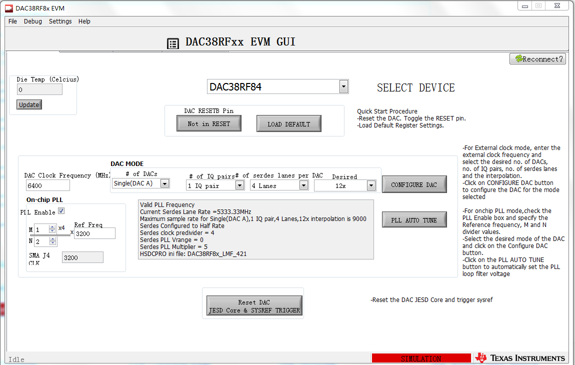

    SYSREF is 26.66M.
    DAC sample rate is 6.4GHz.
    DAC PLL is used, the reference frequency is 3.2GHz. I used DAC38RFxx EVM GUI to configure relevant registers.

    The DAC PLL reference clock is the same as the DAC clock. This is an input that is either used by the DAC PLL logic or bypass and used directly as the DAC clock.
    I did not a get a picture from you showing the DAC38J84 setup you are mentioning. SYSREF must be the DAC data rate divided by K and then divided by any integer to lower the frequency if needed. There are several blocks that require two consecutive SYSREF pulses to reset properly and this frequency is required.
    When I set the DAC to DAC38RF84, M to 1 and N to 2 I get a DAC clock frequency of 800, which is not the same. Not sure what you did here. Which part do you plan on using?
    The file I sent was a copy from another setup that I edited. The updated version is attached. Sorry for the confusion.
    When configuring your board, you should first apply power, then clocks, then a hard rest to the DAC, configure the DAC, then do the initialization sequence called out in section 9.1 of the data sheet.

  • Jim,
    Sorry I forget to attach the picture. I attach it here. Set the reference clock to 3.2G and set M to 1, N to 2, I can get a DAC sample clock at 6.4GHz and serdes clock at 5.333GHz, when select  DAC38RF84.

  • Rita,
    Per the data sheet, the maximum the PLL reference clock frequency can be is Fvco/4. In your case this is 6400/4 = 1600.
    Jim
