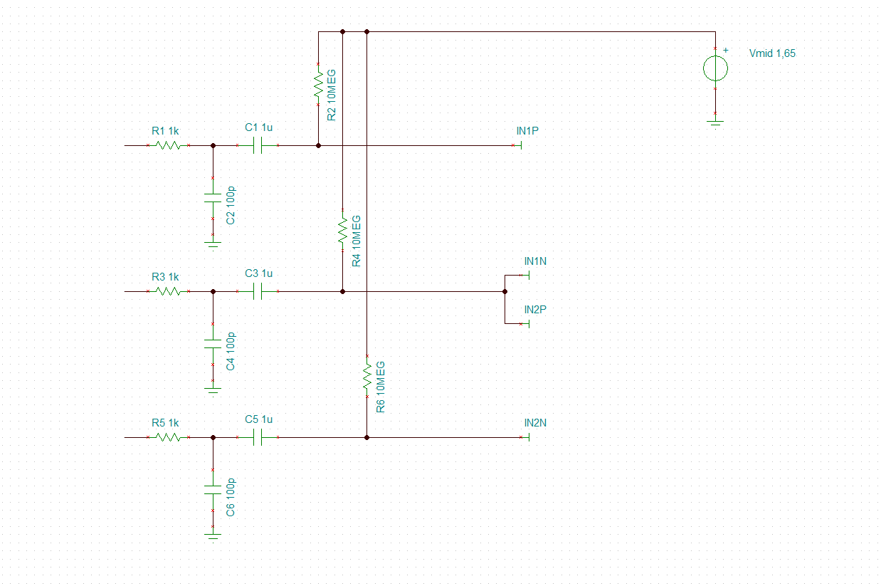

    Thanks for your answer. I am not sure if I completely understand. Maybe I can be a little bit more specific. Lets suppose a battery powered device because this would make the most sense not using RLD feedback because of very high isolation to CM ground and suppose a two lead system which is typical for the ADS1292.
    The input network you propose would look something like:
    You state that that the electrodes must be AC coupled, this is done by C1,C3 and C5. My question is if I remove them what would go wrong?
    IMHO  patient leakage current is not a problem, high-pass filtering can be done digitally and 50/60 Hz common mode rejection will be better, so why do I need AC coupling?

    If you were to short the series 1-uF capacitors in the circuit above, the individual inputs would still be biased to mid-supply via the 10-Meg pull-up resistors to 1.65 V. There would be no concerns with violating the PGA input common-mode range. In that case, you would not need the series caps. In fact, not having them would actually be better for CMRR. You may see a gain error from the mismatch in the resistors, which form a resistor divider, but that's it.
    I'm curious if there was ever another reason behind that original recommendation. We have seen it done that way before. I'll ask around the team if there are any other reasons.

    As I explained in the other post, there may not be any issue with the purely DC coupled approach with pull-up resistors to RLDOUT. Any offsets introduced by the pull-up resistors may not be an issue for lower gain settings. Most likely, PGA gain of 3 to 6 V/V will still have sufficient headroom and still give you the benefit of input-referring the ADC noise low enough.
    I'm not convinced yet whether it's possible to achieve a CMR benefit from the RLD loop in this manner.
  • Hi Ryan,
    " I'm not convinced yet whether it's possible to achieve a CMR benefit from the RLD loop in this manner", I agree, that is the consequence of not using an RLD electrode.
    High CMR is achievable only by very good isolation to the CM ground. In my opinion, the best way to do that is having a battery operated device.It would be nice if TI made a application note using the ADS1292 without using a driving electrode because for ambulatory devices an extra electrode often is not an option and it addresses a considerable share of the market.
