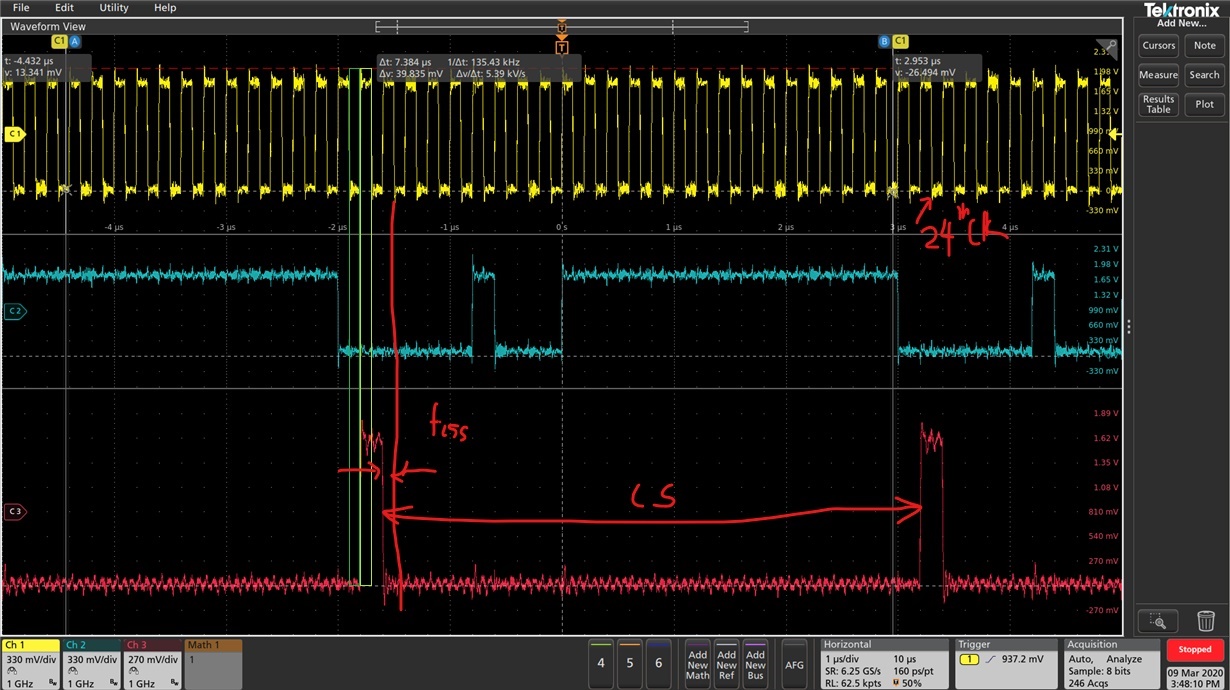

    The BOM part number we have been using is DAC80508MCRTET, and the schematic is as follow:
    The scope shot (yellow - SCLK, blue - SDI, red - CS) for outputting a voltage from OUT0 only:
    We sent MSB to the SDI pin first (0 at 23rd bit for "Write" command).

    From the scope shot it seems like CS goes high along with 24th falling edge of SCLK with no delay in between them (I may be wrong here, please verify)
    We need min 10ns between SCLK falling edge to CS rising edge. Can you please check this and add this delay? Similarly there is CS to SCLK falling edge setup (min 13ns).

    From the figure, the gap (dark green rectangle) between the falling edge of SCLK and raising edge of CS is larger than 10 ns (around 100 ns). (One big grid is 1 us, and one small grid is 200 ns.) Similarly, the gap (light green rectangle) between CS rising edge and the next SCLK falling edge is around 100 ns as well.
    Perhaps my team is missing some time constraints or forget to send some necessary commands , but currently we cannot find anything.
    Thank you very much.
    Your one frame starts from CS going low to CS going high. There is CS to SCLK falling edge set up time of 13ns in your case its greater than 13ns as mentioned in the below pic.
    But then if I start counting SCLK, I am not seeing any delay between 24th SCLK fall edge to CS rising edge. Can you please clarify the same. May be I am missing since the scope shots are not zoomed in.

    Below is an annotated (blue marker) version of the SCLK count. The time between 24th falling edge and CS rising is 100ns (1/10th of time division from scope).
    All our signals are synchronous to SCLK posedge, while the DAC timing is relative to the falling edge. The clock period is 200 ns which means all the DAC timings we are considering are on the order of 100ns.
