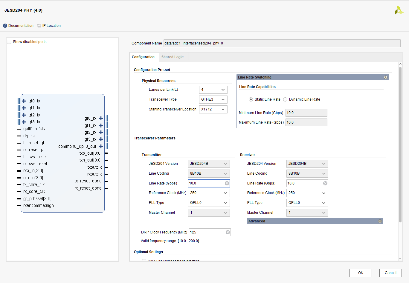

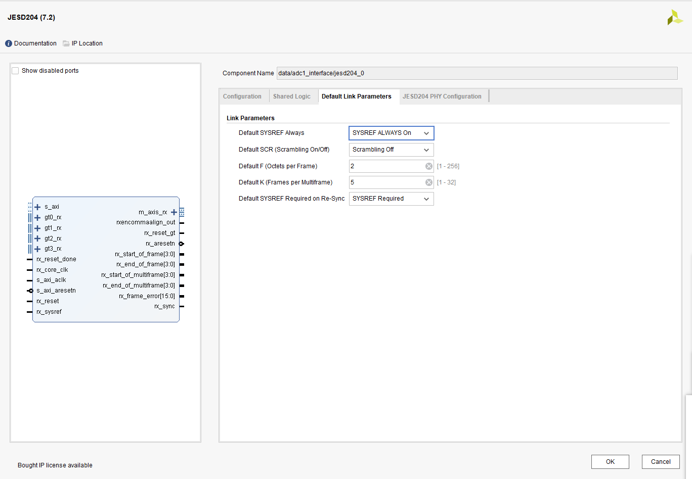

In FPGA , I use the IPcore  jesd204_phy with 10Gsps Line Rate  and the IPcore   JESD204 with F=2, K=16.

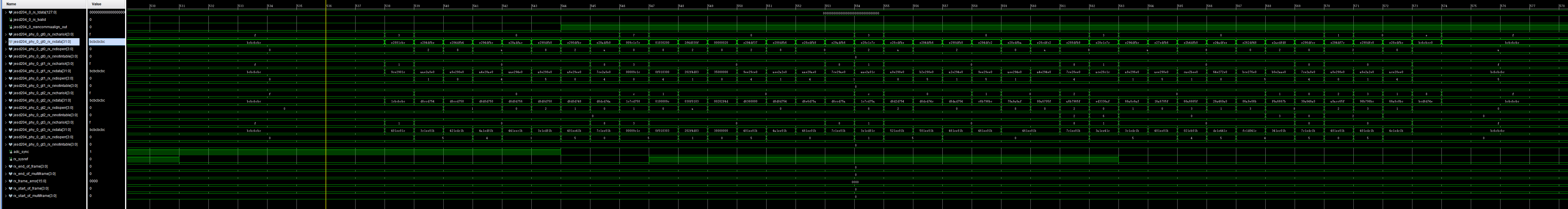

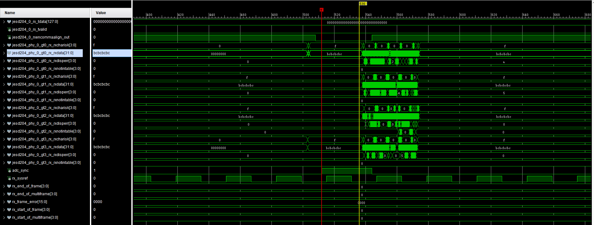

After receiving  K28.5 symbols  in succession,  the IPcore JESD assertes the rx_sync signals. However, it will de-assert the  rx_sync signals in 22 devclk cycles. the debug wave is shown in below.
After the  ILA squence, the gtx_rx_rxdata[31:0] is still "bcbcbcbc", but gtx_rx_disperr[3:0] is not "0", which won't assert the rx_sync signal any more.
Can you help me about that?

    Two IPcores are used as the following:
