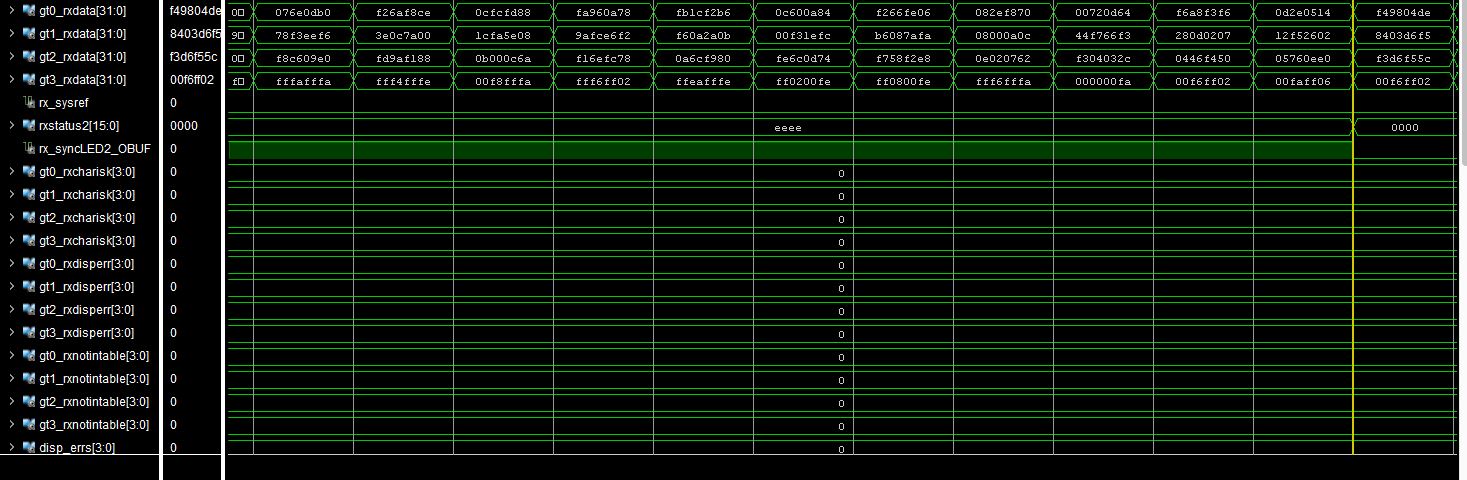

  • Hi Jim,
    I have an update. I received a replacement board and I made same modifications on it as you detailed in your previous response. These modifications were to bypass the onboard oscillator and use J12 for locking PLL2 to external reference clock. I have experienced the same issue where rx_sync goes low after being high for about 2hours.
    I have spent significant time in debugging this issue but haven't seen any progress. Here are my findings -
    Test Setup
    FPGA JESD RX - ZCU102 HPC 1, Line rate = 6.546Gbps, LMFS = 4421, CPLL, RefClk = 163.65MHz, Sysref always ON, GTHE4 location - X0Y15, X0Y14, X0Y13, X0Y12, Coreclk = 163.65MHz. "Shared logic in core", K = 32
    LMK - Sysref = 2.557MHz, Ext Ref clk = 337.8666MHz, VCO = 2618.466667MHz
    ADC - Sampling Freq = 327.3083MHz, LMFS = 4421, Mode 8, No analog signals connected to ADC input.
    I'm attaching the ADC and LMK configuration files here.
    lmkadc337p866.cfg
    1401.ADS_4421_TI_Ticket_New.cfg
    I have been testing this setup on Xilinx ZCU102 and as a sanity check of ZCU102 board being defective, I also tested this setup on Xilinx KCU105. With KCU 105 I observed the same issue. I am attaching the sync loss screenshot here.

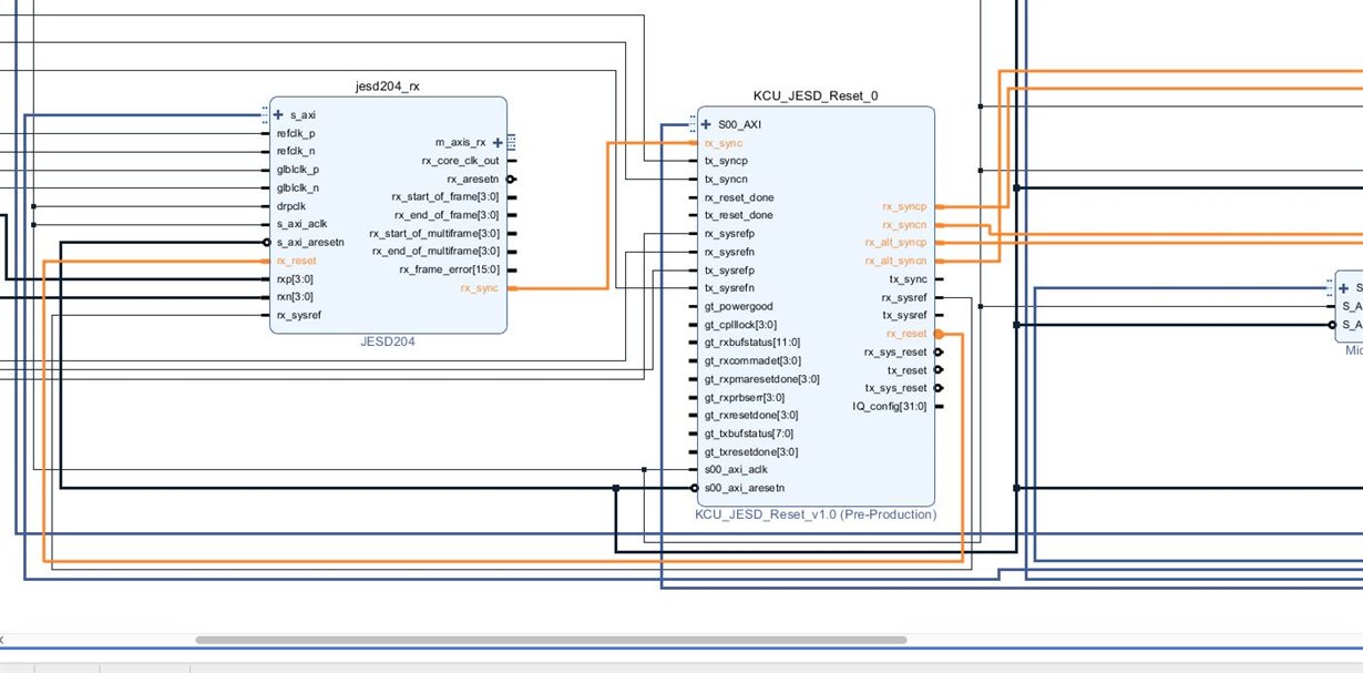

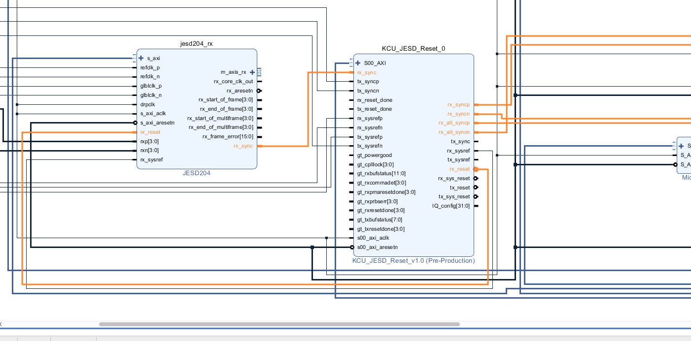

    The block diagram is here
    The Initialization sequence is -
    1) Program LMK and wait for PLL2 Lock.
    2) Program FPGA
    3) Send 1 to rx_reset pin of the JESD RX module (highlighted in above photo). KCU_JESD_Reset module is custom AXI module to reset and monitor JESD module.
    4) Send 0 to rx_reset pin of JESD RX module.
    5) Write 0x2 to JESD RX AXI register 0x04 (fixed reset) to hold the JESD core in reset.
    6) Program ADC registers.
    7) Clear JESD core reset. After clearing reset, the GT lanes start seeing 0xBCBC characters.
    8) Trigger Sysref
    9) rx_sync  goes high indicating sync established. (see below photo)
    During testing, I have observed, rx_sync  remains high for approx. between 2hr 05mins and 2hr 25mins. This time is same for ZCU102 and KCU105. I have tested this at least 20 times and the time for which rx_sync is high, is same between 2hr5min and 2hr25min.

  • Hi Jim,
    I have an update.
    I was using a Hardware Evaluation license for the Xilinx JESD core and that is why rx_sync was going low after a specific period of time. The JESD core has a synthesized timeout that will quit working in 2-8 hours (depending on core, configuration, clock, etc.). A Xilinx engineer provided this information.
    I have purchased a PROJECT license and at the time of writing this post, the link has been in sync for over 24hrs.
