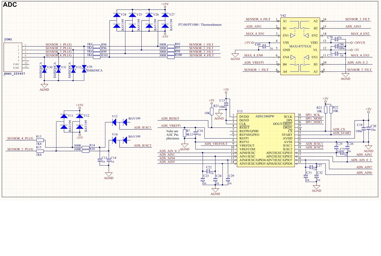

Designing a universal sensor converter I have problems with the ADS1248.
In configuration for thermocouple or RTD measurement I discover a strange behaviour.
For example thermocouple input:
Volt ADC result
1mV 00F200
0,5mV 1E2400...23C600
-0,5mV E7E600...EBFE00
-1mV FEF200
The same problem occurs with RTD input (ratiometric). At resistance below approx. 2 Ohm the ADC result is not correct.
Here my configuration of the ADC for the thermocouple input
positive input: AIN0
negative input: AIN1
VBIAS: VBIAS1
internal oscillator in use
internal reference always on
onboard reference selected
normal operation
PGA: 16
1000 SPS
RevID: 9
DOUT only
IDAC1+2 disconnected
GPIO: Analog input
Voltage at negative input to AGND: 2,474 V
Voltage AIN1/AIN0 is correct
The sensor-voltage is connected to CON1 Pin 2 and 4.
V42 EN1 and EN3 is actice in order to connect the sensor voltage to the ADC
Has anyone a idea what's wrong ?
  • Klaus,
    First, I'd check that there is some capacitance from VREFOUT to VREFCOM. You should have a minimum of 1uF of cap between these nodes and make sure that VREFCOM is connected to an ac ground node through less than 10Ohms. This will ensure the stability of the reference. I think this is the likeliest source of your problem.
    I did want to point out two more things. First the BAV99 works ok because it has a low leakage, but I'd be concerned with the SMBJ30CA devices. If you're only measuring thermocouples, it's probably ok, but I want you to consider that these larger devices have much larger leakages and they get even larger a higher temperatures.
    Another thing to do is make the differential capacitor larger than the common-mode capacitors at the input. As an example, make C22 100n, while C23 and C24 10n. It will prevent common-mode signals from appearing like differential signals.
    Going back to the original question, if the reference cap does not solve your problem, then perhaps there is an issue in the communications. Can you get a logic analyzer to capture your data? Do you wait for a /DRDY as an interrupt to read data? Do you issue an SDATAC and then use RDATA to read the ADC? If there's a problem in communications, there a bit more to debug and I'd need to know how you get data and how the read of the data is timed.
    Joseph Wu
  • Thank you Joseph for your fast reply.
    The 1µF didn't solve the problem.
    We dont use the SDATAC command. We poll the DRDY Pin and then we use RDATA to read the result.
    If it is a general communication problem why are the results above around +/- 0,7mV correct and only the results between +0,7mV and -0,7mV are false and jumping around ?
    Your other comments are correct.
    I have to deal with input voltage up to 30Volts. Therfore the SMBJ30CA.
    I change the capacitors at the inputs of the ADC after testing.
    Klaus
  • Klaus,
    Thanks for checking the VREFOUT cap, I figured that with different inputs, it may have changed the reference loading and therefore the reference stability. This cap is still necessary, and if it is not in your current schematic, it still needs to be included.
    For communications issues, I thought I'd suggest it because if there were a change in timing with changes in input, there might be problems with asynchronous communications (reading data without using the /DRDY indication).
    I would still try to remove the SMBJ30CA (and perhaps the BAV199 devices if it seems to help), just to see if it is a source of problem in your circuit.
    Other than that, let's try to analyze the data coming from the ADC.
    Assuming that you are using some calibrator that can output specific DC voltage, can you please try the following test? Start with an input of +1mV and take 200 consecutive data coming from the ADC. Then set the input to +500uV and get the same 200 data. Do it for 0V input, then -500uV and then -1mV. Just as a sanity check, you may want to apply 100mV to make sure that there isn't a problem with a larger input signal near full scale (I think you are using PGA=16).
    I'm hoping to see if there is any pattern in the output data when it is in error. Maybe there's some sort of repeated pattern, or some periodic noise. It's difficult to imagine such a large variance in the output data with such a small input. However, I'd still like to see the raw data.
    Another thing to try would be to repeat the test but use a different data rate. I would set the ADC to 20SPS and see if the output data has the same error.
    Are you using a precision multimeter to measure back the input? If you are using some sort of DC source, can you check the output signal just to make sure there isn't a problem with the output? You may need an oscilloscope to check.
    Joseph Wu
  • Hello Joseph,
    the 1µF I added to the schematic.
    I don't think that it is a problem of the output of the calibrator (Yokogawa CA150). In order to test this i connected the plus and minus input cables directly together. So the calibrator was not in the signal path and the problem was just the same.
    Now I do the test and logging you mentioned.
    Klaus

  • Hello Joseph,
    I removed the SMBJ30CA and the BAV199 without solving the problem.
    Change of the data rate isn't tested yet. Unfortunately my software colleague is very busy with other things. I have to wait until Monday to make the change of the data rate.
    Klaus
  • Klaus,
    I was able to put the data into an excel spreadsheet to see your results. I'm surprised at what you get, but there are a few things that I noticed and it leads to things to try.
    First, it looks like the input at 100mV, 1mV, and -1mV were basically correct. It does look like you do have an offset of about -60uV based on the conversion results, but it could that there wasn't a conversion run.
    However you are right, the +0.5mV, 0.0mV and the -0.5mV data were in error. Some of the data was very much in error. I'll attach the excel spreadsheet I created. I'd say the 0.0mV was the furthest off, showing an error of almost full scale (with PGA=16, that's a full scale of +/-128mV).
    I would start with the 0.0mV input and check to make sure that you get similar data. Then measure the input and reference to see that you get what you expect (basically a 0V input and a 2.048V reference). Measure these as close to the device as possible. I just want to make sure that the inputs are still correct.
    Then get several oscilloscope readings or readings from a logic analyzer of the digital communications. Record /CS, DIN. DOUT, SCLK. If you have a logic analyzer, record /DRDY and START if you are using it. I want to make sure that what you are reading from your file is exactly what the ADC is putting out.
    The one thing that I noticed that was extremely strange is that from these three inputs +0.5mV, 0.0mV and the -0.5mV, the data is spread out in spaces of 33k codes. I'm not sure if there is something wrong with the transition from bit 15 of the output data, but it is a suspicious result that leads me to think there's a communication error. However, I've never seen anything that's quite like this.
    The difference of 33k codes is shown best on the -0.5mV spreadsheet. What I've done in the 4th column is taken the difference in consecutive data output and plotted them on the graph. Even though the input is closer to what you should be getting as a result, it's still incorrect. Since the difference between successive codes is moderately uniform, I want to confirm that the data coming out of the ADC is accurately captured in the data you report. Using the 0.0mV output has the largest discrepancy, and it'll be easier to see.
    Other than than trying the different data rate may show an error in the read timing. This way there may be more time to clock out the data. However, this seems like less of a possibility.
    I did have another set of questions. For the Yokogawa CA150, where to tie the negative input? Do you use the VBIAS to give the input it's DC bias? Also, when the input is at 0V, do you have the Yokogawa output a voltage so that it's 0V, or do you short the input. If it is the first, then you could try simply tying the inputs together to see if the results are different.
    Joseph Wu
  • Klaus,
    I forgot to attach the file. I'll do it below.
    If you want to attach a file, start with the reply and then click on "Use rich formatting" to the bottom left of the text box. This will open up a rich text format editor with which you can attach the file and add other editing functions.
    Joseph Wu
    ads1248.xlsx
  • Hello Joseph,
    sorry for my late reply. First the software man had no time to change the software then I was ill until now.
    But finally the problem is solved. It was a software issue.
    Thanks for your helpful notes.
    Kind regards
    Klaus Schmidt
  • Klaus,
    Thanks for posting back that you found a solution. If you have any more problems, feel free to post back to the forum.
    Joseph Wu
