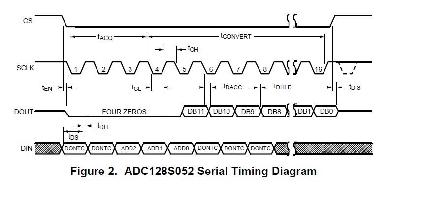

In case the SPI is connected to an 8 bit uC there will be a pause after 8 clocks as shown below:

    SCLK is used for accessing data from the device as well as the clock source for the conversion process. This pause between 8-bit transfers adds to the total conversion time so it is better to keep this time as minimum as possible. See ADC128S052 serial timing below.
    tconvert is the conversion time = 13SCLK cycles (max).

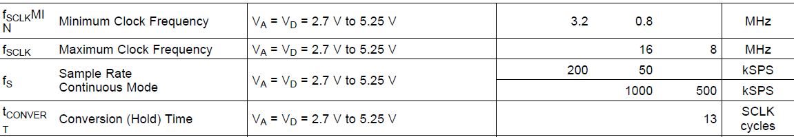

    For meeting the stated performance, DS recommends a minimum clock freq of 3.2MHz so the maximum conversion time (13SCLKs) is about 4us. Beyond this droop on the sample and hold capacitors can degrade conversion results. Note: the device can function to 0.8MHz minimum SCLK so the max conversion time is 13 x 1.25 = 16.25us.
    In your case, the total conversion time is a function of the serial clock frequency and the amount of pause time between 8-bit transfers. Make sure the total conversion time is within above limits.

  • >>>> so if I am using 2 x 3.2MHz = 6.4MHz SCLK resulting in 2µs I can have a 2µs pause in between?
    Yes, limit to 2us or lesser so the total conversion time specs is 4us or lesser.

    There are two specifications in this regard (see DS snippet below)
    I understand minimum SCLK high/low time specs is important and needed to meet DIN/DOUT setup and hold time specifications. See Section 6.7 of the DS. The SCLK duty cycle of 40-60% is there mainly as an alternate way of specify SCLK high time/low time specs.
    For SCLK = 6.4MHz,  you should meet minimum tCH and tCL of 62.5ns. That ensures DIN/DOUT transfers happen without issue.
