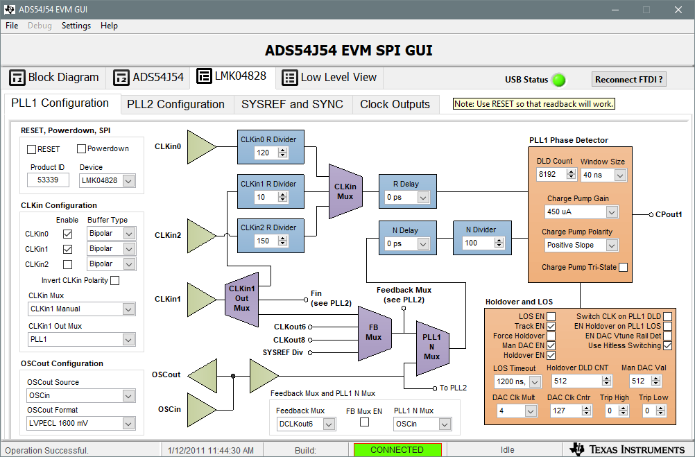

On ADS54J54 -> ADC Configuration Tab check 'Device Reset' checkbox
On LMK04828 -> PLL1 Configuration Tab check 'RESET' checkbox
On Low Level View Tab, click 'Load Config' button
Select ADS54J54_500M_442.cfg
The following 6 screen shots show the GUI state after the config file has been loaded

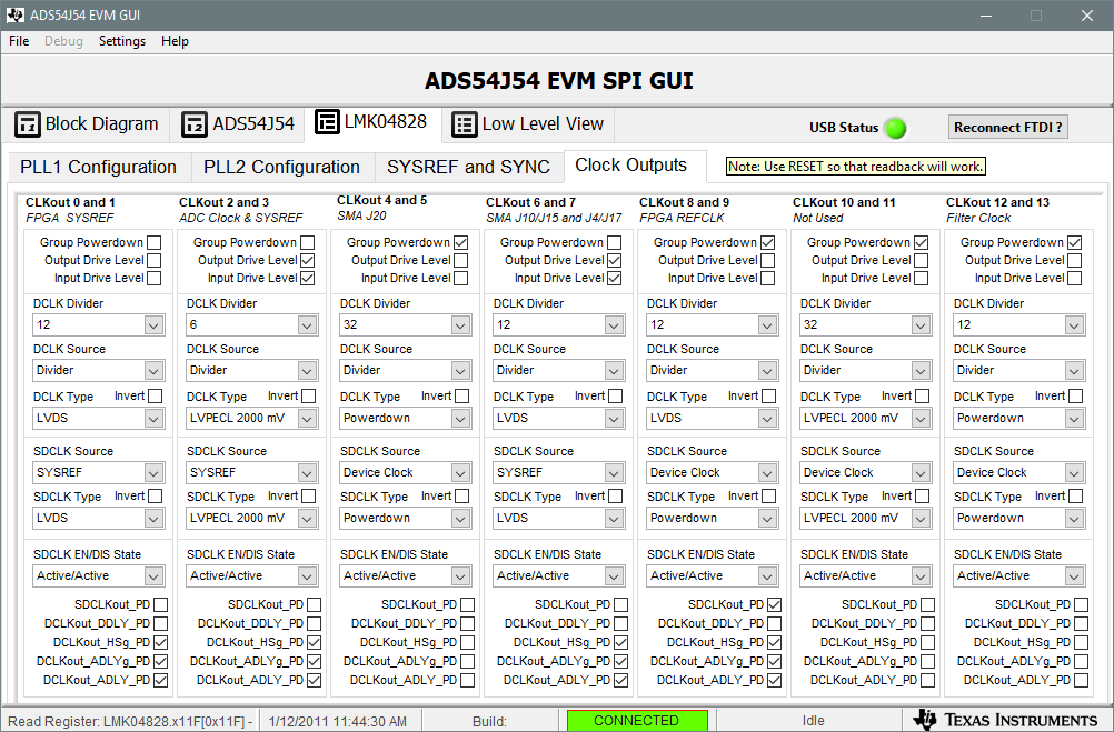

Disabled Group Powerdown for CLKOut 6 and 7
Set CLKOut 7 to LVDS
Confirmed 250 MHZ on SMA J10 (CLKOut 6) - This should be the same as JESD Core Clock going to FPGA
Confirmed 1.5625 MHZ on SMA J17 (CLKOut 7) - This should be the same as JESD Core SYSREF going to FPGA
The screen shot below shows the change in settings to allow 'copies' of the JESD Clock and SYSREF to be observed.

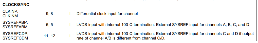

  • The LMK04828 is configured for LVPECL on the ADS54J54 SYSREF input. The ADS54J54 datasheet states these are LVDS inputs

    • I mentioned in my first about a discrepancy in the differential standard for the ADS54J54 SYSREF input, should this be LVDS rather than LVPECL
