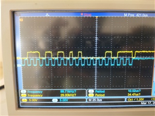

  • Hello Bob B..
    I tried with continuous conversation mode by writing as below..
    1. <S> 0x80 0x06<P>
    2.now i write the configuration registers as below
    <S> 0x80 0x40 0x81 <P>
    <S> 0x80 0x44 0xCA <P>
    3.now i sent the start/sync command
    <S> 0x80 0x08 <P>
    4. Now I wait till the DRDY goes from high to low to send the RDATA command
    <S> <0x80 0x10 <Sr><0x81 {__________} {________} <P>
    this flow I am following I would take the DRDY as the input signal to my FPGA.
    whenever DRDY goes high to low i start sending the RDATA command
    sky blue color signal is DRDY. The remaining one is SDA.
    The DRDY signal is looking like below please find the attached image.

  • Hi Nareshreddy,
    It appears that the communication is working now.  After you read the data from one channel you write the mux change for the next channel.  After you write to the register, the conversion will automatically restart so that the conversion (DRDY falling from high to low) after the mux change will be valid with the newly channel data.
    However it appears that the SCL speed is around 50kHz.  It may be that the mux write command may not have completed prior to the end of conversion for the previously selected channel.  So you would need to make sure that you do not read the channel data until after the conversion completes for the newly selected channel.  One way to prevent this overlap is to speed the SCL clock up so that both the RDATA and WREG commands take place in less than 1ms time of the conversion.
    The code flow would be the same as the single-shot mode except you would not need to transmit the START command after each channel change.  Sending the START command will not hurt anything as the conversion will restart a second time, but will delay the end of conversion.
    Bob B

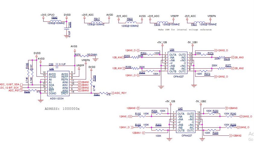

  •  Hello Bob B..
    Now I am able to receive the data from all channels in continuous-conversation mode.
    I applied 3.3 v to all channels. for this, I am getting 0xAB9C  or 43932 decimal value. I want to know how to convert this value to voltage to verify whether whatever we are giving right or wrong.
    i selected External reference selected using the REFP and REFN inputs as reference.
    Gain as 1.
    Please find the attached ADS112C04 connections.
    Please let me know the formula to convert these values to voltage.
    For ANI 0 i am appling 3.3 V
    Nareshreddy
  • Hi Nareshreddy,
    Remember that the output code of the ADS112C04 is in binary 2's complement.  0xAB9C is not a positive value but rather a negative value.  Positive values range from 0x0000 to 0x7FFF (+FS) and negative values range from 0xFFFF (-1 decimal) to 0x8000 (-FS).  The maximum positive code is 32,767 so 43932 is not a valid code.
    I'm confused by your input circuit as I see no place to actually input a voltage.  I assume the input connects to U64 for a gain of -1/2 and then to U45 for a gain of -1.  For a 3.3V input, the output would be 1.65V if I'm correct with respect to the circuitry.
    You are using the analog supply as the reference voltage for a 5V reference.  The value of 1 code or LSB is given in the datasheet as (+/- VREF/Gain) / 2^16.  In your configuration this would be 10V/2^16 for a gain of 1 or approximately 152.6uV per code.  Dividing this number into 1.65V is 10813 codes (0x2A3D).
    There are a few things I noticed in your schematic.  You have AVSS connected to -2.5V through FB22.  But you also have AVSS connected to ground through R76.
    I also noticed that the output of the op amp is directly connected to the analog inputs.  You must be very careful to protect the inputs as the op amps are powered from +/- 5V and if the output should rail the input to the ADS112C04 will exceed the absolute maximum input voltage and most likely will damage the ADS112C04.  I would advise making sure that the maximum current from the op amps through the ADS112C04 inputs is kept to less than 10mA.  This can be achieved by using series resistance.  You may also want to add some caps to create a low-pass filter.
    Bob B

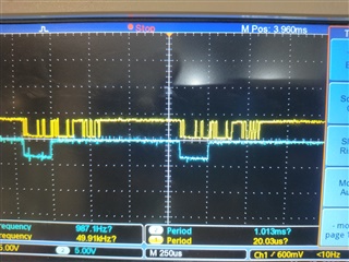

  • Hello..
    I am writing configuration register 1 with as below
    for ANI 0 i setted as below
    I am getting the SDA data like below .
    Yello one is SDA
    sky blue is SCL
    The final conversation results am I am getting as
    0x6A86 in decimal 27270 if i apply ANI0 as 3.3 V (3,3 V is dividing by gain and ADS112C04 is getting 1.65 V)
    if i apply 0 v to the ADC channels ANI 0 to ANI 3 i am getting 0x3FBF in decimal 16369
     For a 3.3V input, the output would be 1.65V if I'm correct with respect to the circuitry. yes your correct IN ADS112C04 ANI 0 I am getting 1.65 V .R76 is DNM (it is not mounted in PCB )
    AVDD is 0+2.5 V
    AVSS is -2.5 V
    Please tell me how to measure negative voltages also.

  • Hi Nareshreddy,
    When you use bipolar analog supplies (+/- 2.5V) and you select a mux setting for AINP = AIN0, AINN = AVSS, note that the measurement is not with respect to AGND but instead AVSS.  So if your input is 1.65V relative to AGND, the output code will reflect the result relative to AVSS (-2.5V).  Code 27270 equates to a measured voltage of about 4.16V above AVSS (-2.5).  To see the result relative to AGND you need to subtract 2.5V. 4.15 - 2.5 = 1.66V relative to AGND.
    In the case of a 0V input (codes 16369), you can see that the output code calculates to about 2.5V.  When you subtract 2.5V you get 0V (2.5 - 2.5 = 0V).
    When you measure relative to AVSS you will only utilize 1/2 of the full-scale range as AINP will never go lower than AINN and you will never see a negative output code.  If you want to measure above and below AGND, you will need to set one of the inputs to AGND (0V) and measure relative to that input.
    For example, if you set AIN3 to AGND, you will have 3 inputs that can measure differentially relative to AGND (AIN0/AIN3, AIN1/AIN3 and AIN2/AIN3).  In this way you can measure above and below AGND.
