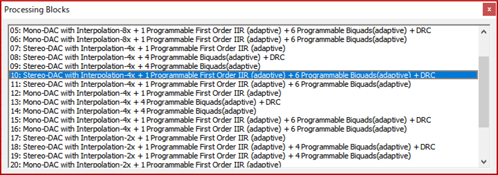

I could not find tab or window to change processing block.
We want to select and evaluate processing block, PRB_10 PRB_P10, PRB_P25 and so on.
How to change processing block in latest GUI?

  • Hi Na Na,
    I would recommend you to use the GUI version on the web.
    CCDAC310x is mostly used for TLV320DAC3100, as this device is not supported in the other GUI version.
    -Ivan Salazar

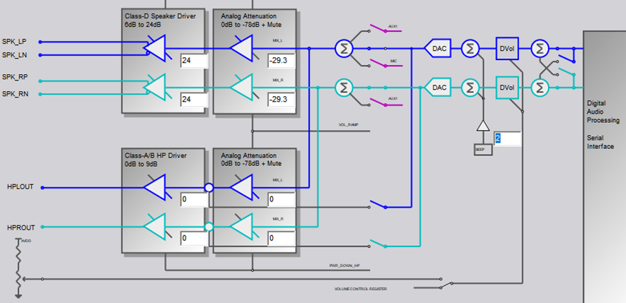

    Our customer says DRC function could not work well on the EVM.
    Configuration:
    INPUT: Audio source from the PC
    OUTPUT : HP out
    Processing block: PRB_P10
    Could you please check how to use DRC in processing block?
    BestRegards

  • I'm able to see the DRC working on an EVM from my side.
    What I would recommend to do for a better appreciation of the DRC effect is the following: Input a Full-Scale signal, set DRC Threshold = -24dB, increase the DAC gain to max (24dB). At this point, if DRC is properly setup, the output should be full-scale. Then gradually reduce the DAC gain by using the slider in the GUI, you'll see how the output amplitude is slightly reduced but the DRC takes effect and adjusts the output to full-scale, until the slope of the DRC is linear.
    You should be able to see the registers changing in real time when changing the DRC settings using the GUI. Is the EVM connected and working properly before they adjust the DRC settings?
    -Ivan Salazar
    Applications Engineer - Low Power Audio & Actuators
  • Hi Ivan
    Thank you for reply.
    We could confirm output is adjustedby DRC without clipping even if DAC gain is increased.
