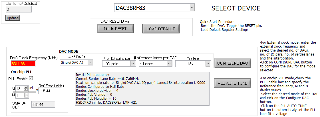

DAC38RF82EVM: PLL frequency invalid in DAC38RF82EVM GUI
Part Number: DAC38RF82EVM
My customer has a related question.
Their configuration is as follows.
[Q]
Why is this setting invalid PLL frequency ?
My understanding as follows.
  • High VCO accept this DAC frequency.
  • Internal PLL for DACCLK can generate in this configuration.
  • SerDes PLL can generate the serdes clock.
Therefore why ... ?
