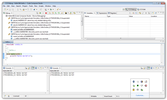

    By default you get something like this.  Where I have 2 consoles open but it is showing the output from all cores and shows the core name in front of it:

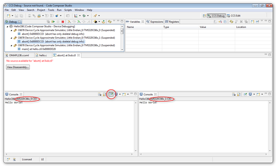

    However if you right click on your launch in the debug view and select "Edit X..." where X is the name of your project or the ccxml file (depending on the type of launch you have) you will get this dialog.  There is an option to use or not use the shared console.  Uncheck this.  The terminate your debugger and launch again.
    Here I still have 2 consoles open.  I have pinned the first console to core 0.  Then when I ran core 1 the second console showed the output from core 1 but the first one is still showing the output from core 0.  I used hello world for both so I circled the core name so that you can see where the output is coming from.  I also circled the pin button.
