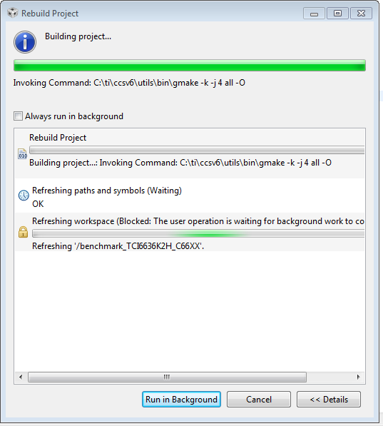

    Before I imported our project into CCSv6, it took about 30 seconds. After, it takes 3 minutes 55 seconds for the  "refreshing path and symbols (0%)" to finish!!!!!!!!!!!!!!!!!!!!!!!!!!!!!!!!!!!!!!!!!
    I'm using a Dell T7500 with 24GB or RAM and a SSD drive. CCSv6 is unreasonably slow!!!!!!!!!!!
    I believe its due to Eclipse trying to parse all the TI platform generated files. I wonder if there is a way I can tell it to ignore that particular project.
    Cheers
  • I can't believe how bad this tool is now. I opened the build properties -> include options and just closed the window. I didn't change a thing and it goes into "Refreshing paths and symbols" again for over a minute.
    What a waste of time. Why does CCSv6 need to refresh when I haven't changed ANYTHING!

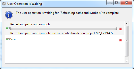

    Could it be that the slowness has got to do with the number of .c and .h files in my project that eclipse parses when trying to create editor symbolic links? (like linking to a declaration and definitions to function calls)
    Ki-Soo Lee said:
    If you close the project, it should not parse/scan it.
    But if I close the platform configuration, then it won't get linked when I build my application right? (update: my app won't build without the platform config project open).
    I noticed that its stating "Invoking scanner config builder on project M2_EVM6472" even when I save a file. What pops up is the window below. Can I turn off the auto config builder somehow?
    Also, is there a way to get it to do an incremental build instead of a clean build each time? Hopefully I can find where this setting is. I don't think I had to play with it in CCSv4.

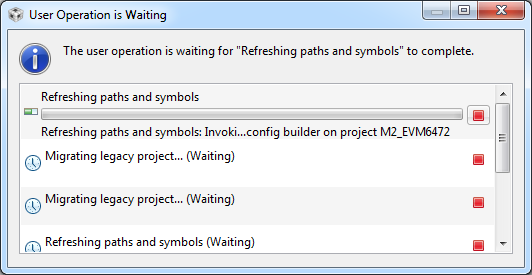

  • Another one of my co-workers has installed CCSv6. It takes about 3-4 minutes for the "Refreshing paths and symbols" to complete on his new installation.
    He also has the same issue that CCS goes into this mode of ""Refreshing paths and symbols" awhile before finally gets to building a single file you've edited.

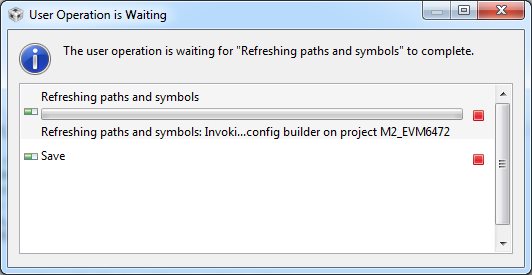

    CCSv6 itself starts quickly. But when you highlight the project, thats when the "Invoking...." starts along with the 4 minute countdown.
    I think we could reduce this time by telling CCSv6 not to run the scanner config builder on our platform project. I tried closing it like the TI staff suggested, but then the project app doesn't build .

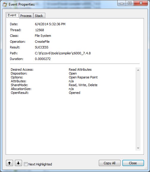

  • Hi Eddie,
    Could you post your <workspace>/.metadata/.log file?  It might provide some insight into the problem you're seeing. It would be best if you could also provide us with the project so we could reproduce the problem locally.
    - Baltasar
  • Hi Baltasar
    I attached the log. Would it help if I also sent the window's "process explorer" log?
    Unfortunately, I can't send the entire project since its production code.
    Cheers
    Eddie

  • Hi Baltasar
    Its definitely the project because CCSv6 is up in a flash (relatively speaking) with other workspaces I've created.
    Unfortunately I can't share the project since its production code. But anything else I can capture for you, i.e. logs etc, I'll gladly do because this is really slowing down our team. (and I'm the main scapegoat since I suggested we migrate to CCSv6).
    I used Process Explorer to monitor that CPU loading while "Invoking Configuration Builder" is running and its hardly using any MIPs (less than 4% CPU load). So I can't understand why it takes so long.
    I noticed that it says its "Migrating Legacy Project". Perhaps something is not being written back correctly to one of CCSv6's config files that tells it that the project has been converted?
    Cheers
    It might be performing file I/O. Can you run Process Monitor and use the "File Summary" in Process Monitor to see which file(s) CCS is accessing during the delay?
  • Hi Chester
    Thats a great idea, maybe its hanging on a file(s).
    The "Invoking Configuration Builder"  (aka "refreshing paths and symbols") process is also called when I close CCSv6. It takes a couple minutes to close. I uploaded the Process Monitor logs showing the part of the closing process (about a minute)
    It looks like its thrashing meta data files.
    http://e2e.ti.com/cfs-file.ashx/__key/communityserver-discussions-components-files/81/2117.processMonitor_5F00_FileSummary.7z
    http://e2e.ti.com/cfs-file.ashx/__key/communityserver-discussions-components-files/81/7573.ProcessMonitor_5F00_processOnClose.7z
    http://www.7-zip.org/
    http://technet.microsoft.com/en-us/sysinternals/bb896645.aspx
  • Here are the logs on open
    It seems likes its cycling through a process of creating files in the compiler directory, TCPIP directory and others.
    http://e2e.ti.com/cfs-file.ashx/__key/communityserver-discussions-components-files/81/6013.processMonitor_5F00_FileSummaryOnOpen.7z
    http://e2e.ti.com/cfs-file.ashx/__key/communityserver-discussions-components-files/81/6811.ProcessMonitor_5F00_processOnOpen.7z
  • http://e2e.ti.com/cfs-file.ashx/__key/communityserver-discussions-components-files/81/6813.ProcessMonitor_5F00_processOnUpdatePlatformBuildParams.7zSame thing is happening when hitting OK after updating the platform build parameters.
  • Hi
    I completely erased the .metadata file as per the trouble shooting instructions.
    http://processors.wiki.ti.com/index.php/Troubleshooting_CCSv6#CCS_Diagnostic_Logs
    Then I imported my example projects (staircase and message que). After this, I closed CCS and opened it several times. CCS was very quick to start and close.
    Then I imported our production project into the same workspace. It took about 3 minutes. CCS is spending a log of time opening and close a file many times in the compiler directory. See Process Monitor log
    http://e2e.ti.com/cfs-file.ashx/__key/communityserver-discussions-components-files/81/2728.CCSv6_5F00_ImportProjectAfterCleanedWorkspace.7z
    Then I closed CCS and opened CCS again. It took about 4 minutes "refreshing symbols....." was done. The log shows its again thrashing at file open and closing.
    http://e2e.ti.com/cfs-file.ashx/__key/communityserver-discussions-components-files/81/7282.CCSv6_5F00_OpenedAfterImportingProjectAgain.7z
    I hope this can be resolved soon. Perhaps there is an eclipse setting I can do that stops the configuration builder? The tool is extremely painful to use as it is.
    Cheers
