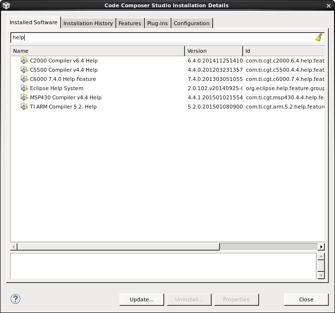

E.g. the following from the Code Composer Studio Installation Details reports that help for all compilers is installed:

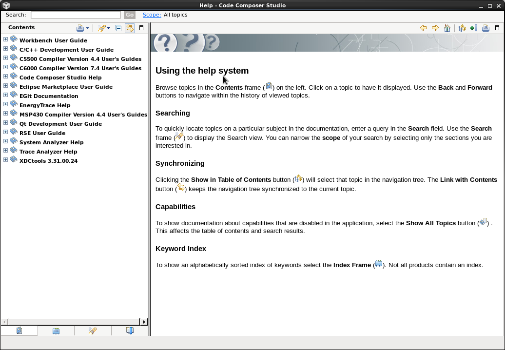

Yet the CCS help doesn't show the ARM or C2000 compiler help:
