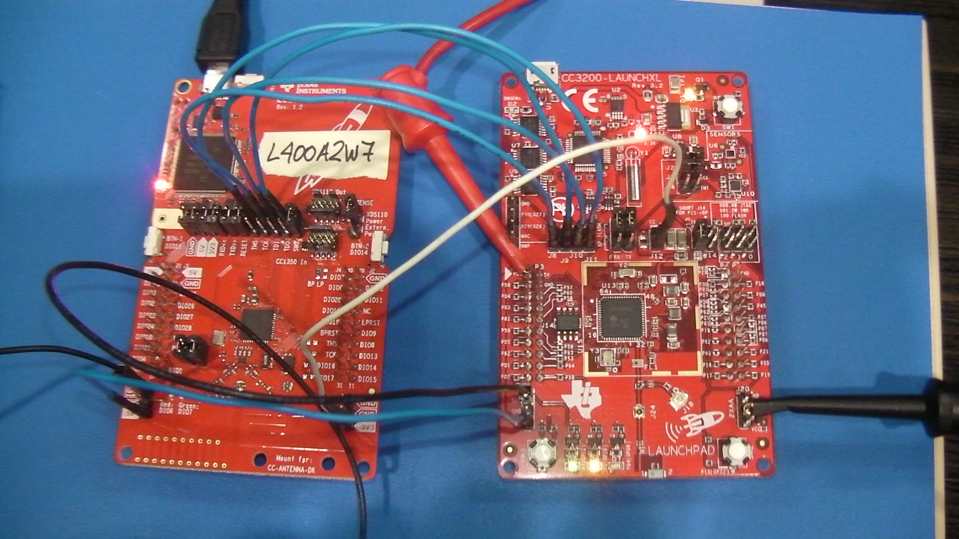

    Thank you for sending the contents of the two files.
    I copied the contents of each to .ccxml files and opened them with CCS - their configuration is identical.
    I then used a different launchpad that has a XDS110 and, by means of a "frankenstein" connection, I was able to connect to my CC3200 Launchpad just fine.
    In my case I have the SOP jumpers all pulled to set the debug mode to 4WD but nothing else was required.
    In light of this I suspect that somehow the XDS110 connections to the board are incorrect or too noisy (despite the 100kHz on the TCLK).
    If you have a launchpad, would it be possible to test the XDS110 on this hardware in an attempt to isolate all variables?
