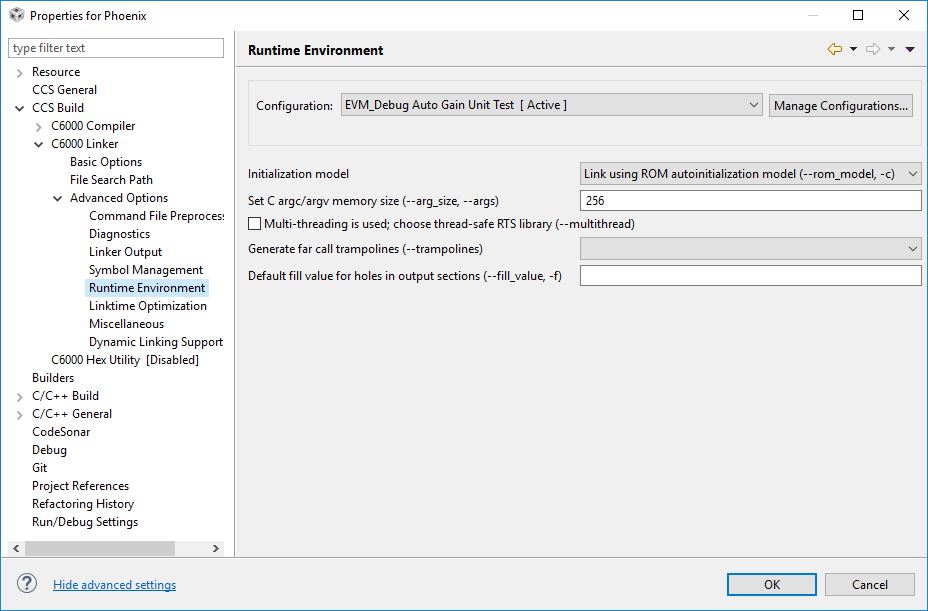

  • Hi Ki
    Thanks for your answer. I just add the lnker option --arg_size=1024, but it still doesn't work. I cannot find the section, .args, in the output map file. The argv in the main() function is still 0x00000000. Do you miss any step in setting the .args section?
    Thanks!
    Wai Kwok

  •     CCS  Version: 6.2.0.00050
    Compiler Version: TI v7.4.21
    Link Flag:
    -mv6600 --abi=eabi -O3 -g --define=_DEBUG --define=SOC_C6678 --define=VERSION_FOR_DSP --define=_OS_SUPPORT --define=UNIT_TEST --define=AUTO_GAIN_UNIT_TEST --display_error_number --diag_wrap=off --diag_warning=225 --mem_model:data=far --strip_coff_underscore -z -m"C:/git/PHX-1278-sip-autogain-enhancement/DevProjects/Output/dsp_app.map" -i"C:/ti/c6000_7.4.21/lib" -i"C:/ti/ipc_3_44_01_01/packages" -i"C:/ti/c6000_7.4.21/include" -i"C:/ti/pdk_c667x_2_0_5/packages/ti/csl/lib/c6678/c66/release" -i"C:/ti/dsplib_c66x_3_4_0_0/packages/ti/dsplib/lib" --reread_libs --warn_sections --diag_wrap=off --display_error_number --xml_link_info="Phoenix_linkInfo.xml" --rom_model --arg_size=256 --zero_init=off
    I tried repeating the problem with compiler v7.4.21 and CCS 7.2. I can't repeat the problem in that after setting --arg_size to 256 in the project properties:
