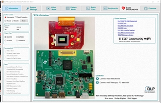

Excuse me, I got these two boards a few days ago, but I want to ask about the connection method of the two boards. I tried to use the cable connection as shown in the picture, but the status of the GUI of my computer is shown as the picture. It seems that the DMD is not connected to the DLP board

  • Hi YU-CHEN,
    Cable connection is proper.
    Can you power up the EVM and share GUI Screen capture.
    Also share information about the LED indications on the EVM when powered up.

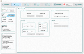

  •  When my EVM is connected to the computer, it reads the 670S chip, but I am using the 500YX chip
  • Hi YU-CHEN,
    Looks like firmware needs to be updated.

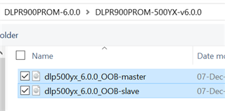

    1. Download the latest firmware from below link. Version: 6.0.0
    https://www.ti.com/tool/DLPR900#downloads
    2. Once the downloaded file is installed, Firmware is placed in below location.
    C:\Texas Instruments-DLP\DLPR900PROM-6.0.0\DLPR900PROM-6.0.0\DLPR900PROM-500YX-v6.0.0

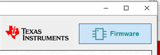

    3. Remove EVM Power, Place HOLDBoot jumper (J12),  Power up the EVM, Open the GUI, Make sure connection status shows Green.
    4. Select DMD as DLP500YX
    5. Click on Firmware page
    6. Click Browse, Select DLP500YX firmware (Select both master and slave files)
    7. Click Upload
    8. Firmware download will begin. Wait till the firmware update gets completed.
