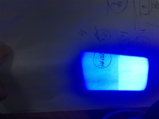

I want to test the internal pattern mode of 4710lcevm ,created a large number of 1D patterns, all of them are 1920x1080, 8bits,and horizontal
Then I run the projector ,open the GUI and information page is as follow

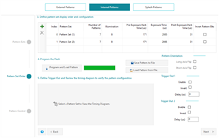

I select the internal pattern streaming mode follow the guide and add two pattern sets: both of them contain 7 horizontal 8bits 1d pattern, u can see them in GUI page directly
In step two ,I chose the color, set the exposure time, pre-exposure dark time and post-exposure dark time according to release note ,patterns loaded normally
After that I click run continuously button and was disappointed to find that the picture was divided into two parts: the left part played well but the right one flashed ,fluttered and sometimes turned into black screen

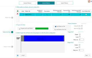

I tried to create a pattern set included only one pattern, after the same operation I find the consistent result, which means the reducing the number of the patterns is not the cause of the problem.
I also changed the timing and nothing was improved.
Could u tell me the reason?
