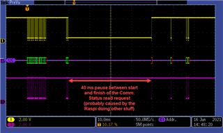

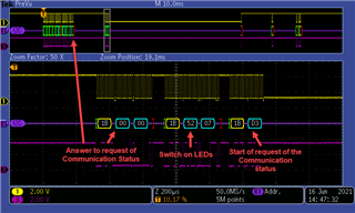

we are experiencing rare communication errors with our DLPCs. After they initialized we tell the DLPC to switch the LEDs on. Sometimes it can happen that checking the Communication Status afterwards shows a "Command Processing Error" (0x04) for Op-Code "0x00".
We saw that during the "read request" for checking the Communication Status there can be a pause of up to 40 ms between the "0xd3" byte (Op-Code for Communication Status) and the "0x02" byte (read parameter: I2C).
My questions are now the following:
1. Can a delay of 40 ms between the two bytes of a read request lead to the DLPC aborting this request? (Because a timeout happens while waiting for th read parameter)
2. What does Op-Code 0x00 actually mean, as it does not refer to an existing Op-Code?
For better clarification of the situation I added screenshots of the communication.
I have not found any answers to these questions in the respective datasheets and manuals so any hint is appreciated.

    I think my screenshots were a bit misleading. The 0x00 in the first screenshot is the answer of the DLPC to a request of the Communication Status which happened before the first longer period of inactivity observable in the CLK signal (yellow). Everything you see on the screenshots is communication with the DLPC. At no time are we issuing a request with an op-code 0x00.
    Also I'm not sure that the long delay is the DLPC needing its time because when I had a closer look at the signal it is visible when the DLPC holds the clock and when it releases it (visible as a slightly lower signal voltage in the CLK signal for a short time). This is also visible after the 0xd3 Byte in the first screenshot, right before the long pause. This long delay happens only once in ca. 1000 boot cycles and is most likely caused by the I2C driver of the Raspi.
    We are checking the Communication Status after every single transaction. So most of the time the answer by the DLPC is 0x00 0x00 (no error). Only after the command to switch on the LEDs when we try to read the status again sometimes there is this long break between the op-code and the read parameter for the Communication Status read request and that is when we get 0x04 0x00 as an answer. And I don't know why and what it means.
    I hope I could clear up things a bit? I added some comments to my screenshots which may also help.

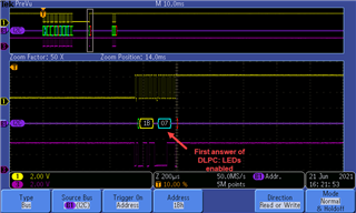

  • On a closer look I became convinced that the time the clock is held low is most probably the DLPC using clock stretching. This is visible in the attached screenshot with three different voltage levels of the CLK line.
    So from the controller side everything looks fine. That still leaves the question, what the strange looking answer of the Communication Status means
  • In the meantime I tested NOT checking the Communication Status but instead re-reading the registers that we wrote values to. So for instance after we enable the LEDs we want to check whether the change was successful so we read the status of the LED enable register.
    Since in the beginning we had problems with our controller not handling clock stretching correctly we could run into problems where we read wrong data. So we employed a scheme where we would try multiple reads and compare the results. This was still active when I now checked the LED enable status and on successive reads I got three answers, where the first and third answer indicated that the status was "enabled" but the second answer indicated "disabled". How can this be the case?
