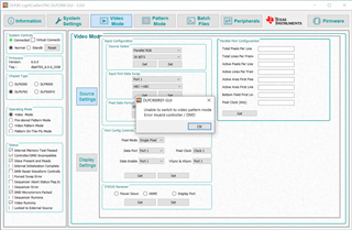

Hi Team,
We have received this inquiry from our customer.
We purchased the DLPLCR67EVM (DLP670S DMD) with a DLPC900 controller very recently, and encountered the following error in our initial attempt to set it up: "Unable to switch from Memory Mode." and the Controller/DMD Incompatible status box is ticked. It does say our evaluation module is 'Connected' and running in the 'Normal' mode. We are also unable to select any operational modes as the GUI interface repeatedly redirects to 'Video Mode'.

  • Hi William,
    It is recommended to check DMD for damage.
    "Controller/DMD Incompatible" error is set even when Controller is not able to communicate with DMD. When Pins of DMD are shorted, there is high probability that DMD is not initialized and not running to respond to requests from controller.
    What is the status of controller board now. Since firmware update is failed, does controller firmware version still reads 6.4.180?
    If boot loader is accidently erased during firmware update process, UM232H is needed to load bootloader file.
    Latest bootloader can be found in installation directory.
    C:\Texas Instruments-DLP\DLPC900REF-SW-5.0.0\DLPC900REF-SW-5.0.0\DLPC900REF-JTAG
    Refer to Section "3.11 JTAG Flash Programming" in EVM user guide https://www.ti.com/lit/pdf/dlpu028 for detail on UM232H connections and bootloader update procedure.
    Shivakumar

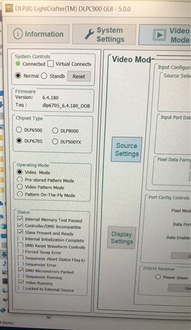

  • Hi Shivakumar,
    Good Day. Please see the customer message for your response. Thank you very much.
    We have successfully reloaded bootloader using JTAG flash programming, and updated the firmware of our board.
    The GUI home page says firmware is now version 6.0.0.
    The "DMD/controller incompatible error" is still there though -- please see screenshot.
    The DMD is in "Connected" mode; D5/D11/D12 light up green, and D7/D9 are flashing green.
    We are in the process of generating the debug log using Tera Term.
    Please let us know what else we can try.
    Thanks!
    Ray Vincent
