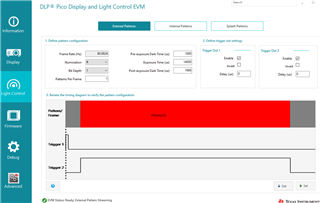

  • I used an oscilloscope to measure the trigger of the DLP. When I set the frame rate to be 10Hz and the pattern per frame to be 24 on the software, the frame rate that the oscilloscope shows is 5Hz, and only 12 patterns per frame. See the figures below.
    Actually, no matter how I set the exposure time and dark time, the pattern trigger seems to be always at 60Hz. Is there something wrong with the DLP? Or something wrong with the output trigger? Can I change the pattern rate?
    Jieliyue

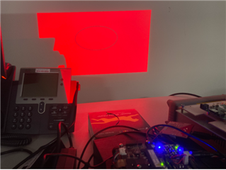

  • Thank you. I noticed the Vsync is the same as the refresh rate of my laptop.
    Do I need specific software to open the image? I encode the 2D black and white patterns into each bit plane of the 24-bit image. Then I opened it with Matlab, connect to the DLP, and set the bit depth = 1, patterns per frame = 1 in DLP's light control mode. But I noticed that the displayed patterns is slightly different from the first bit plane of the image. For example, this is the first bit plane of the image:
    This is the displayed patterns:
    You can see that especially around the edges, they are not the same. So does other patterns I tried. But I need the patterns to be displayed correctly. Is it because of the DLP or other factors?

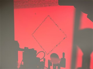

  • Hi Arthur, I did exact the same thing as you suggested. Here's the image I displayed on my laptop:
     which is a 1280*720 .bmp file generated by Paint.
    The DLP displays:
    I made sure that the resolution on both screen is 1280*720, and pressed F11 for display. The setting for external pattern mode is
    But I can still see some artifacts. Can you show me the result you got using the same image as mine? Thank you.
    Jieliyue
  • Sorry the image on my laptop should be this:
  • Hi Jieliyue,
    I think that something about your video source is incorrect
    your GUI configuration looks OK, and your .bmp is good. please make sure your video source resolution is correct. double check and image scaling other features that may be having an effect
    Arthur
  • Hi Arthur,
    I double checked on my laptop and it's correct, 1280*720 for resolution. I even used 2 laptop for testing and in both case the artifacts will appear. Can you send me your result using the same image if possible? Also can I load the images to the flash drive and display them as 2D patterns?

  • Hi Jieliyue,
    I reproduced the setup on my own EVM and did not have any artifacts. I attached all my settings
    I believe this artifact is because the resolution of the .bmp and the resolution of the DMD need to be aligned perfectly, or the video data gets interpolated and causes a bunch of garbage to appear on the display.
    You can load a series of patterns onto the device in Internal pattern mode, but in this case you are limited to 1 dimensional patterns, not 2D like the oval, or diamond pattern you shown,
    Arthur
  • Hi Arthur,
    Thank you so much! You're right that they need to be carefully aligned. Now there is no artifacts.
