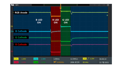

the problem is, RGB operation is different between the IC is pressed by hand, and just normal operation.
here are the waveforms and color of DLP product.
1. normal operation
2. when press IC or bend the PCB
You can see that RGB anode level is low when B LED ON compared to normal operation, finally the LED looks like blue color is very weak. (it looks like light green)

    Since this issue is sensitive to pressure on the IC I suspect it may be related to a poor solder connection. Is this issue seen on multiple boards?

    here is more information from the customer ;
    1. they followed TI reference design for their schematic.
    2. they re-worked with new IC and heat gun, but it appeared again.
    3. it is seen on every boards, even it have differences how strong should I press each boards.
    and here is one more thing they tested.
    - if they set the current value of LED low, this symptom can re-produce easily. but they set the current high, they hardly re-produce it.
    - they designed some vias on exposed pad for DLPA2005. they think that the impedance through via would be changed when they press the IC or bend the PCB. so the current would be changed and this symptom happens.
    => is it possible situation?
