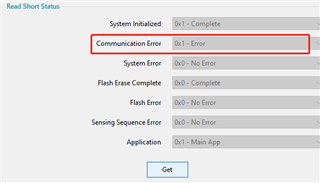

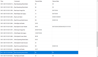

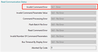

    We used the board of Dlp3010 to verify that this problem did not occur. I ran the same way for a week and continued to project. Dlp4710 is easy to be unable to project after running for 2 hours. I would like to ask you, at this moment, what state or IO pin state can I analyze to locate the fault of DLPA or DLPC?
    When I operate on Evm-Gui, sometimes the following errors appear, but after continuing "get", the errors disappear again.
  • Hi Andy,
    these errors would indicate that the controller did not understand the op code sent from the msp430. is it possible for you to look at the I2C bus when this issue occurs? if you can do this and then compare to working conditions it may shed some light.
    Also you say that " we can successfully send the RunOnce command with the evm-gui program on the computer side, but it is not bright at all." Does the pattern project but it is dim? or not at all?
    Arthur
  • Hi
    1)“Invalid Command error ” is caused by the "get" operation on the information page in evm-gui. It has little relevance to this problem. I2C bus can still be used.
    2)When there is a problem, the internal mode RunOnce operation, the projection light is not bright at all, and other "get" operations are normal, which will not cause an error prompt. Finally, it doesn't light up after using test mode or splash mode, but after these two operations, the GUI starts to report I2C error.

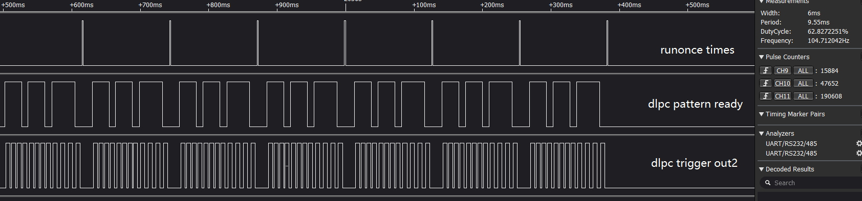

    Through the logic analyzer and counting board, we record the number of "RunOnce" sent and the output of "DLPC out2" and "pattern ready" signals. After 15884 cycles, the DLPC stops projecting. It is normal to continue other I2C operations at this time.
