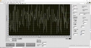

DLPNIRNANOEVM: Labview implementation of PGA_Gain and Slew Scan
Part Number: DLPNIRNANOEVM
I am developing Labview code for controlling the TIDLPNIRNANOEVM. I have successfully implemented rest of the code and can control the spectrometer through the code. But I cannot implement PGA_Gain and Slew scan. Can you please tell me at which point the PGA_Gain command should be applied? Because it cannot be applied as a parameter to Scan_Configure function.
Also I cannot find any command for writing a new scan configuration with Slew scan. So, can you please tell me how I can implement it?
Moeen.
