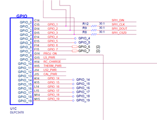

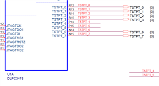

  • Jiaqi,
    Let me elaborate in hopes of helping explain the above more clearly:
    There are two signals TRIG_OUT_1 and TRIG_OUT_2 as described in the DLPC3478 datasheet: https://www.ti.com/lit/ds/symlink/dlpc3478.pdf
    If you go to Table 7-3 you will see that these two signals are sourced from TSTPT_4 and GPIO_07 respectively. These signals are both labelled as such in the schematic for this EVM: https://www.ti.com/tool/TIDA-080003
    Using pads attached to these signals, you can measure TRIG_OUT_1 and TRIG_OUT_2 per the instructions Mayank provided in a post earlier and print the results to an oscilloscope. At the moment, we suspect that the pattern configuration you are using is not being properly reflected in the actual system. Based on these trigger output signals, you should be able to determine the real behavior of the system and adjust your GUI configuration accordingly.
    I hope this helps.
    Philippe

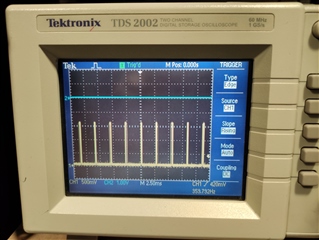

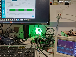

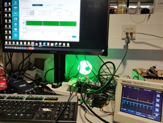

  • Dear Philippe,
    Thanks for the confirmation of the power-related question.
    I've got the photos for both the 8-bit mode...
    and 1-bit mode:
    To my point of view, the 8-bit mode has the correct trig_out signals.
    But the 1-bit mode does not.
    (for the 1-bit mode, I can see the trig_out1 is 60 Hz, not 104.2 Hz, according to the manual. And there are 5 Trig_out2 pulses, instead of 3.)
    On my AMD RX550 video card settings, the output frame rate of ITE6801 is always 120 Hz.)
    Please let me know if there are any parameters/settings I should take care of...
    Thanks very much.
    (it's 7 pm here at GMT+0 zone, I'll reply on Monday. Cheers.)
    JH

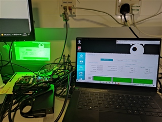

  • Hi guys,
    Are there any updates regarding the "8bit mode flickering" and "1bit mode incorrect pattern interpolation"?
    I've done more tests with a photodiode and collected some data in the figures, shown below.
    Note: in the 8bit mode, there are 360Hz white screen flashes at "black screen". in the 1bit mode, the frame should be split into 3 patterns, not 5.
    The pictures were the signals from a photodiode, which is placed in front of the DLP3010.
    Looking forward to the solution (for displaying a 360Hz video stream from a 120Hz HDMI source, without any unwanted flashes).
    Cheers.

    I've tried again, the result is the same, still has 360Hz flickers.
    Figure (left) 360Hz pulses from the photodiode. (middle) the arrangement of the DLP, photodiode, and a "BLACK" screen (full screen of a black bitmap image, looks green because of the 360Hz flicker at 8-bit Green channel mode.). (right) data of the photodiode from a black screen to a non-black screen.
    The video card we use is an Nvidia RTX3070 in a newly purchased gaming computer (with a decent 750W power supply).
    (So far, we tried video cards from Radeon RX550, RTX3070 (laptop), and RTX3070 (desktop), all with the same result.)

    I bumped into a previous post on TI, describing the input/output difference on ITE6801: https://e2e.ti.com/support/dlp-products-group/dlp/f/dlp-products-forum/595782/dlp3010-different-data-between-input-and-output-of-ite6801
    Is there any solution for that?
    And how may I access the PDATA pins on the DLP3010 on my side, to make sure the ITE6801 output is correct?
    Thanks very much.
    JH
  • Hi JH,
    Please see the design files for this EVM here: https://www.ti.com/tool/TIDA-080003#design-products. You will need to trace or extract contact points for probing the PDATA lines on the controller side.
    Thank you,
    Chris

    Instead of soldering 24 cables to the PDATA pins, I used 1-bit mode to output 23 bits pattern (not 24 bits) of a white screen, and the photodiode gets...
    As the image shows, the HDMI signal should be 0xFF = 255 (white screen), but the photodiode gets 11010111 = 0xD7 = 215.
    And the photodiode gets one pulse in each pattern on a black screen, where the HDMI signal should be 0x00 (not 0x01 or 0x80).
    (The HDMI input was set to 60Hz during the test, I am hoping to get a 180Hz output from the DLP.)
    The previous post (Link) showed something similar, where the input and output of the ITE6801 were different.
    I suspect, there is something wrong with the ITE6801 output during the black screen, which causes the 360Hz flashes described previously.
    May I ask what was the signal train look like, when using the HDMI signal from ASTRO?
