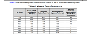

  • Heekong Lee,
    Please refer to table 4-1 in the LCR4500 EVM user guide for the minimum exposure time required shown below.
    Akhil

  • Heekong,
    If you use a single color LED, it does not change the minimum exposure time per bit. Rather, it simply reduces the total number of bitplanes being shown. You may want to see if you can use a more suitable camera for your application.
