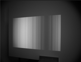

The manual say that 8 bit  pattern consists of time slots like below
In case the camera and the project does not match, i.e. not the same, some artifact occurs like below picture.
We need the very short exposure of a camera, so  1/8 of min. projector's exposure, that is 8.3ms.
However, that artifact still exists. what is the period of bit planes' time slot?
Thanks in advance.
  • Heekong,
    From your summary above, it sounds like the exposure time of your camera is not sufficient for the patterns you are attempting to stream. Is this correct? What camera are you trying to use?
    If possible, you may want to consider a high-speed camera for your application.
    Philippe
