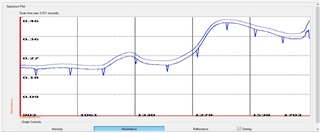

We are having a problem with two DLP® NIRscanTm Nano EVM devices. They were working normally but in the latest analysis they are showing noisy spectra. When starting the spectra acquisition, we read a reflectance pattern in "new" mode.
We've already checked aspects like PGA Gain we're using in automatic mode. In addition, we use Hadamard mode with 228 wavelengths and 10 scans to average. Settings are attached. We made a series of acquisitions that way, however, only the last ones became very noisy. Is it a hardware issue? What tests could we do to verify?
Also, we use devices connected to a portable battery as instructed by the datasheet, could this interfere with the acquisition?
