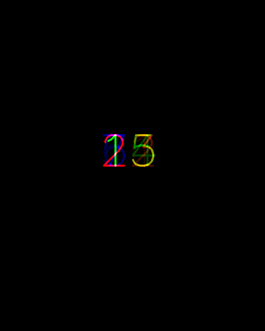

We have a DLP4500-AFQD which is being driven by a custom board with a DLPC350 chip.
We are supplying a video signal into the LVDS port of the DLPC350 which is being sequenced onto the DMD.
One test we perform is to set the DMD into pattern streaming mode from the video port, and select only a single bit plane at a time (0, 1, .... through to 23) and ensure that we can see the image corresponding to that bit plane.
(The test image is something like this, where each bit plane has a different number in it, making it easy to see on the DMD).
This test typically works fine, but recently we have had a situation where we see nothing on the DMD when we select bit planes 0, 1, 8, 9, 16, and 17.
That is, when cycling through the bit planes, we can successfully see all numbers except 0, 1, 8, 9, 16, and 17.
In other words, it looks as if there are now only 6-bits for red, green, and blue.
Interestingly, it looks like the bit planes that are not visible are the first two bits of the red, green, and blue channels.
We have a hub in the system so that our video signal goes:
Laptop --> (USB3.0 Hub (USB-C connector) with HDMI port out) --> (Custom board for conversion from HDMI to LVDS) --> DLPC350 --> DLP4500
If we remove the Hub from the chain and go straight from Laptop --> (Custom board...) then we get the missing bit planes back.

  • Hi Oliver,
    If the hub cannot handle 24-bit RGB data, then we recommend using  a separate piece of hardware. Please provide some more information on your system schematics so that we can review with our hardware team.

  • Hello Oliver,
    Welcome to DLP forum and  thank you for your interest in DLP technology.
    I assume that you have your own board and not using TI EVM.
    In addition, we are testing a new custom PCB for connecting to the electrical pads of the DLP4500-AFQD part.
    Questions:
    1. could the Hub cause something like this?  How?
    Based on your description , it seems the hub is causing a problem. When you drive directly from Laptop  through HDMI port , it works. It is very difficult to guess why? One of the  possible reason - Hub is converting data from Type C to HDMI (video over type C). The HUB is treating the data as video image and processing it is based EDID description of HDMI in the custom board. There could be miss-match.

  • Hi Vivek,
    Thanks for your reply.
    1. We have tested by using a different brand of Hub, which does not seem to cause those issues.  We have a custom EDID structure, can we send this to you by email for inspection?
    2. The "missing" bit planes are missing when we use the hub, but are present when not using the hub.  In both these cases we are using the SAME custom PCB.   So, putting the hub into the system causes the bit planes to go missing.  Can the custom PCB cause only some of the bit planes to go missing, perhaps because the addition of the hub changes the timing ever so slightly?
    3. Thankyou, we will reach out to them.

  • Hello Oliver,
    I am glad to hear that you found another hub which works well.
    The hub is transforming the data. It is difficult to say/guess what the format and content of the data to custom PCB.
