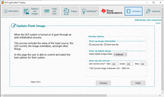

We have been trying to design a system for a DLP3010 DMD projector using a DLPC3438 controller and DLPA2005 PMIC.  After a lot of struggle we believe the LED current is too high at start-up in our application, causing a brown out.

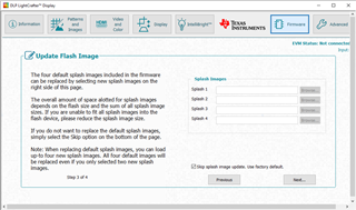

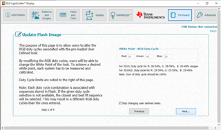

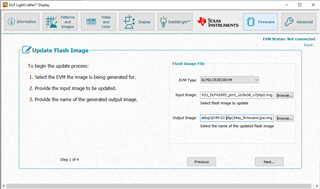

We've tried two different tools (DLP LightCrafter Display v7.4 and DLP EVM GUI 3.1.0.5) to modify the firmware with lower LED currents at startup.  However, neither tool will properly recognize the input firmware image file.  And we've tried both, a backup of the original flash image supplied with our DLPDLCR3010EVM (not Gen 2) and an image downloaded from the TI DLP Pico Firmware Selector tool (FWSel_DLPC3433_DLPA2005_pm1_i2c0x36_v7p4p2.exe)

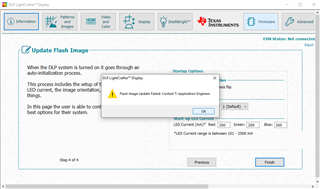

DLP LightCrafter Display reports "Flash Image Update Failed." as follows:
  • With input file that is a backup from a DLPCDLPR 3010 EVM eval kit: "Selected input image does not match the EVM type. Input image is meant for a DLPDLCR 2010 EVM"

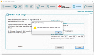

  • With an input file generated by TI DLP Pico Firmware tool.  "Flash Image Update Failed: Input flash image error"

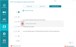

DLP EVM GUI reports "EVM type cannot be recognized" with either input image.
We can really use some help obtaining a firmware image with LED currents set to minimum at startup that works with the legacy DLPCDLPR 3010 EVM (DLPC3438/DLPA2005) eval kit.  If it's an image that is also compatible with the DLP LightCrafter Display's Flash Image Update page would be great.
