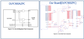

hi , I am H/W engineer.
We had developed DLPC900ZPC(old part) Board that driving DLP6500BFYE.
Now, TI announced DLPC900AZPC(revision part).  So I check two datasheets and find difference that DLPC900AZPC has RESERVED_PIN(H22,T22,U23)  flash memory address function.
Our board flash memory is one 64Mbyte part.  If DLPC900AZPC is installed in the our board. Is there no problem?(RESERVED_PIN(H22,T22,U23) is no connection in our board)
Is there another difference between two parts?
schematic is the same that each datasheet says[one 64Mbyte flash connection]
