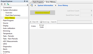

  • Hello -
    After the module flashes, can you please read the "Error History" and share the results?
    Ross

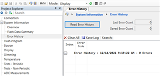

  • Hello Ross -
    When switching the display source, the optical module flashes but never casts any light.
    After the module flashes, the error history is read as follows:
    Of course, we can also find the results of ADC Measurements.
    So why doesn't the optical module display the image?

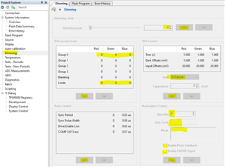

  • Hello Yang -
    What is the Dimming Level set to? From the "Dimming" page:
    Also, please ensure that all cables are properly attached to the engine.
    Ross

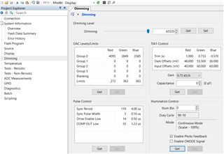

  • Hello Ross -
    All cables have been connected according to DLP5530PGUQ1EVM Evaluation Module User's Guide.
    In "Dimming" page,the Dimming Level is set to 65536:
    As for some operations, I hope you can provide specific operation procedures, because I may overlook some key details.
    Looking forward to your reply.
    yang
  • Hello Ross -
    As for the dimming setting you mentioned last time, the optical module still did not project light after I set it. Please refer to my other reply yesterday for relevant Settings. Thank you.
