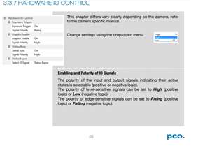

    Thank you very much for your help. It seems that our customer's inquiry is about the device he needed to trigger the EVM. I have requested a photo of the camera as well as the user manual which I have attached below.
    I noticed that the camera has two input and two output connectors. Can he connect the Output 3 or 4 directly to pin 2 or pin 5 and ground of J20 (if the voltage from the camera is 3.3V) then set the polarity of the I/O signal to high or low as shown in Section 3.3.7 of the user' manual?

    This guide is for the software, but not the specific camera model.  The serial number does not help.  Rather, can they provide the model number?

    The part number of the camera is pco.edge 4.2m. Here is another manual from the camera manufacturer.

  • Hello Danilo,
    The second document supplied (PCO-Edge Tirg.pdf) is about the camera's trigger timings, but does not provide any information about the voltage levels and other connection requirements.  The customer needs to reach out to the camera manufacturer to determine what levels and connection type is expected by their specific camera.

    I asked the customer to request this information from the camera manufacturer and he provided this details.
    The camera has:
    trigger input signals frame trigger, acquire (SMA connectors) Pin 1
    trigger output signals exposure, busy (SMA connectors) Pin 3
    It required TTL signal which is of voltage level 3.5V - 5V
    I have checked the schematic diagram of the EVM and I noticed that the input buffer is operating at 1.8V or 3.3V depending on the jumper setting of J19. It seems to me that the customer has to use a voltage level translator or maybe a voltage divider from the Output 3 of the camera to pin 2 of J20 of the EVM. Is my understanding correct?

  • Danilo,
    I looked over this camera and it's specs.  This camera is either rolling shutter or global reset with a phased readout which makes the exposure time different for different parts of the array of the camera.  It can be done with some work, but this really requires a conversation with the customer.
    It is not a simple matter of just hooking up the trigger one way or another.
