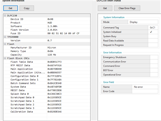

  • Hello Vinay -
    I can provide a new flash binary that defaults to HDMI 1152x576 input. But first, can you please take a screenshot of the "System Information > Overview" page in the DLPC230 Control Program? Be sure to press the "Get" button.
    Ross
